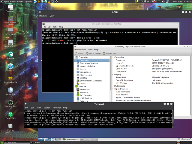

Linux 7.0.6 with KVM-PR:

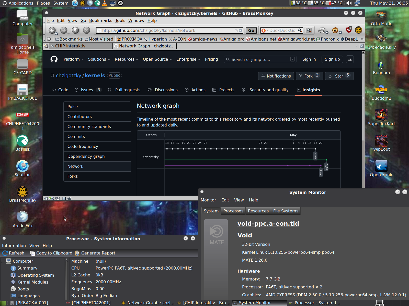

Posts: 11544
Here is the RC4 of kernel 7.1 for X1000 and e5500 machines (X5000/20, X5000/40, Mirari, and QEMU VMs).
Posts: 11544
I have released the stable long-term kernel 5.10.256 with fixes because of the ssh-keysign-pwn vulnerability for X1000 and e5500 machines (X5000/20, X5000/40, Mirari, and QEMU VMs).
Posts: 11544
Here is the stable long-term kernel 6.12.90 with the ssh-keysign-pwn fix.
The stable long-term kernel 6.12.90 with access via BrassMonkey 34.2.2 to the new PROXMOX VE 9.2.2:
The stable long-term kernel 6.12.90 with access via BrassMonkey 34.2.2 to the new PROXMOX VE 9.2.2 (reduced IO delay):
Have a nice weekend,
