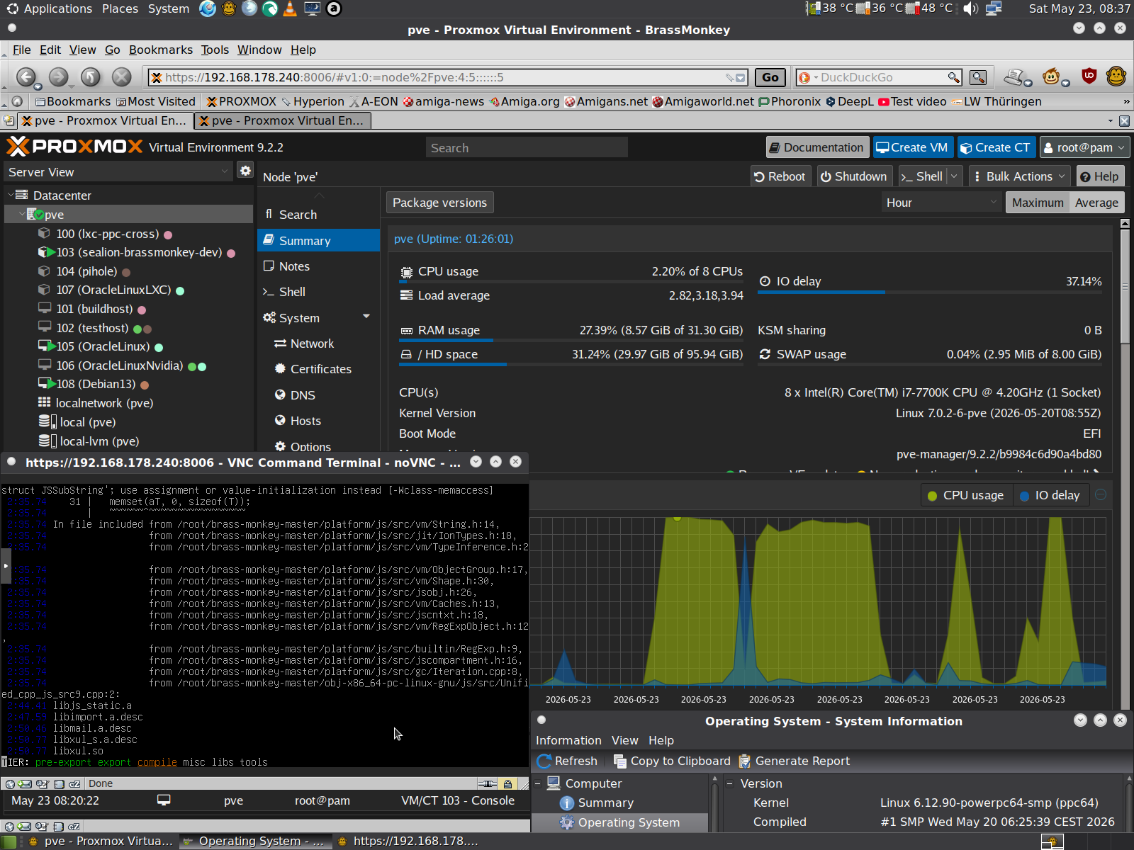

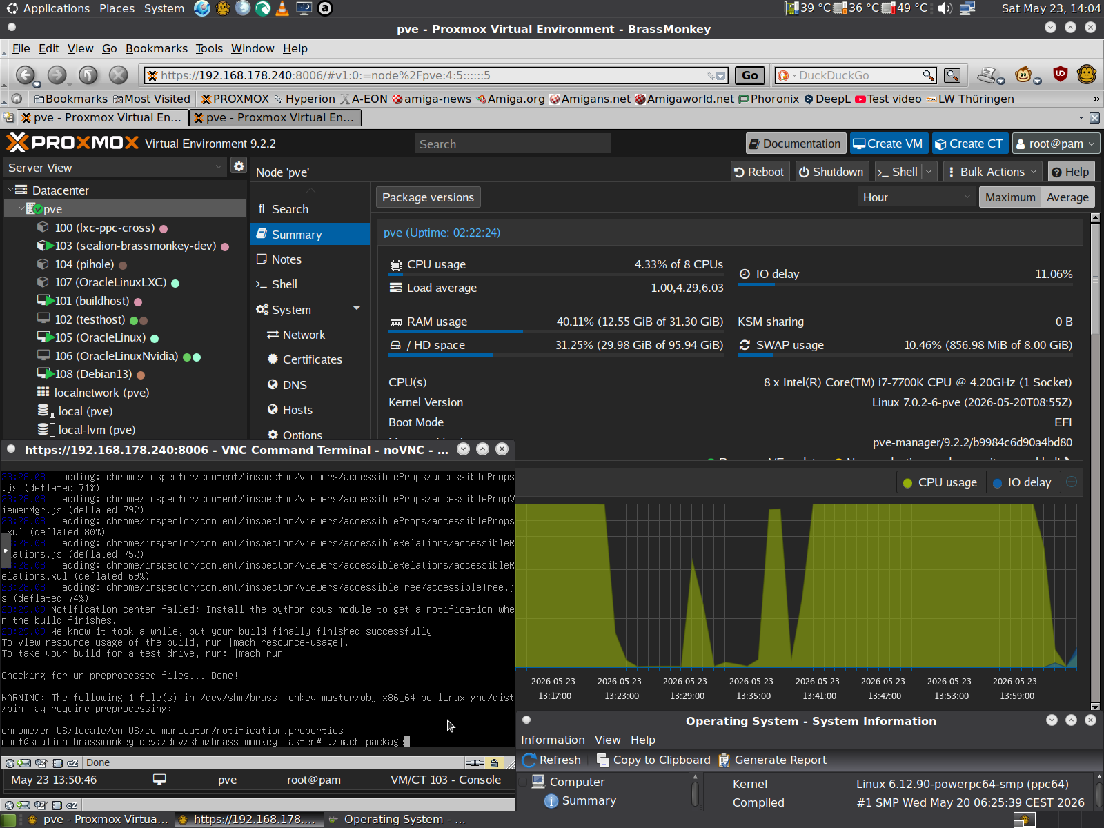

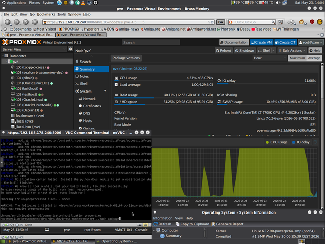

Here is the stable long-term kernel 6.12.90 with the ssh-keysign-pwn fix.
The stable long-term kernel 6.12.90 with access via BrassMonkey 34.2.2 to the new PROXMOX VE 9.2.2:
The stable long-term kernel 6.12.90 with access via BrassMonkey 34.2.2 to the new PROXMOX VE 9.2.2 (reduced IO delay):
Have a nice weekend,
