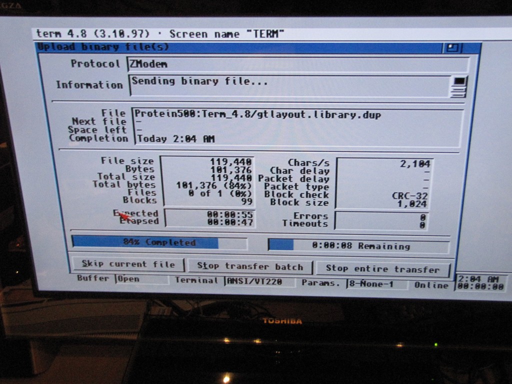

Re: X1000 Serial <--> A500 Serial ?
ZeroG send me a Link to the Gtlayout.library V47.2 .
With this it goes fine. !
SOLVED !
See :
SOLVED !
See :
