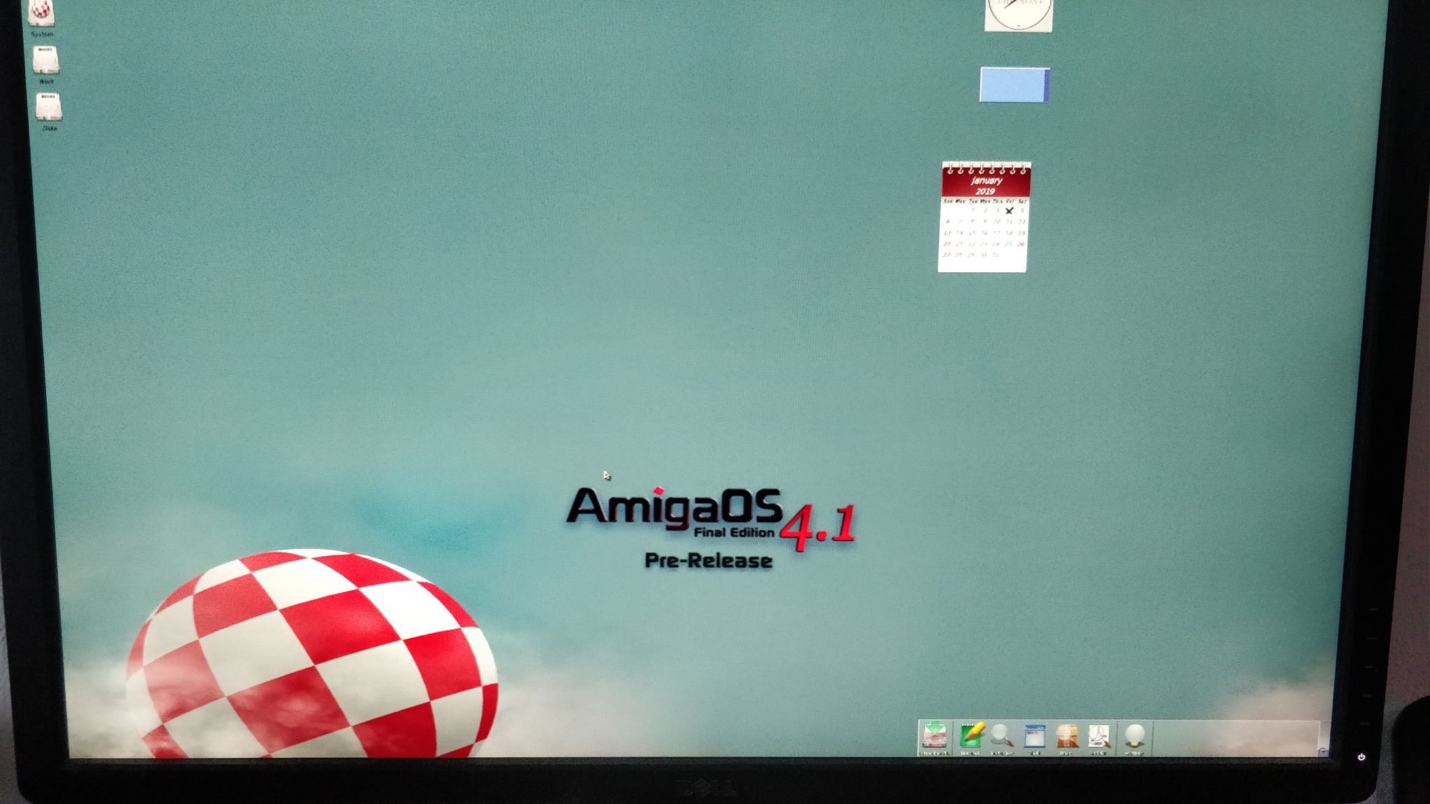

As promised some screenshots:
At first sight the resolution 2560x1600 looks fine if you take a look at the desktop as is seen in the screenshot I have taken with my phone:
Desktop 2560x1600
Desktop 2560x1600

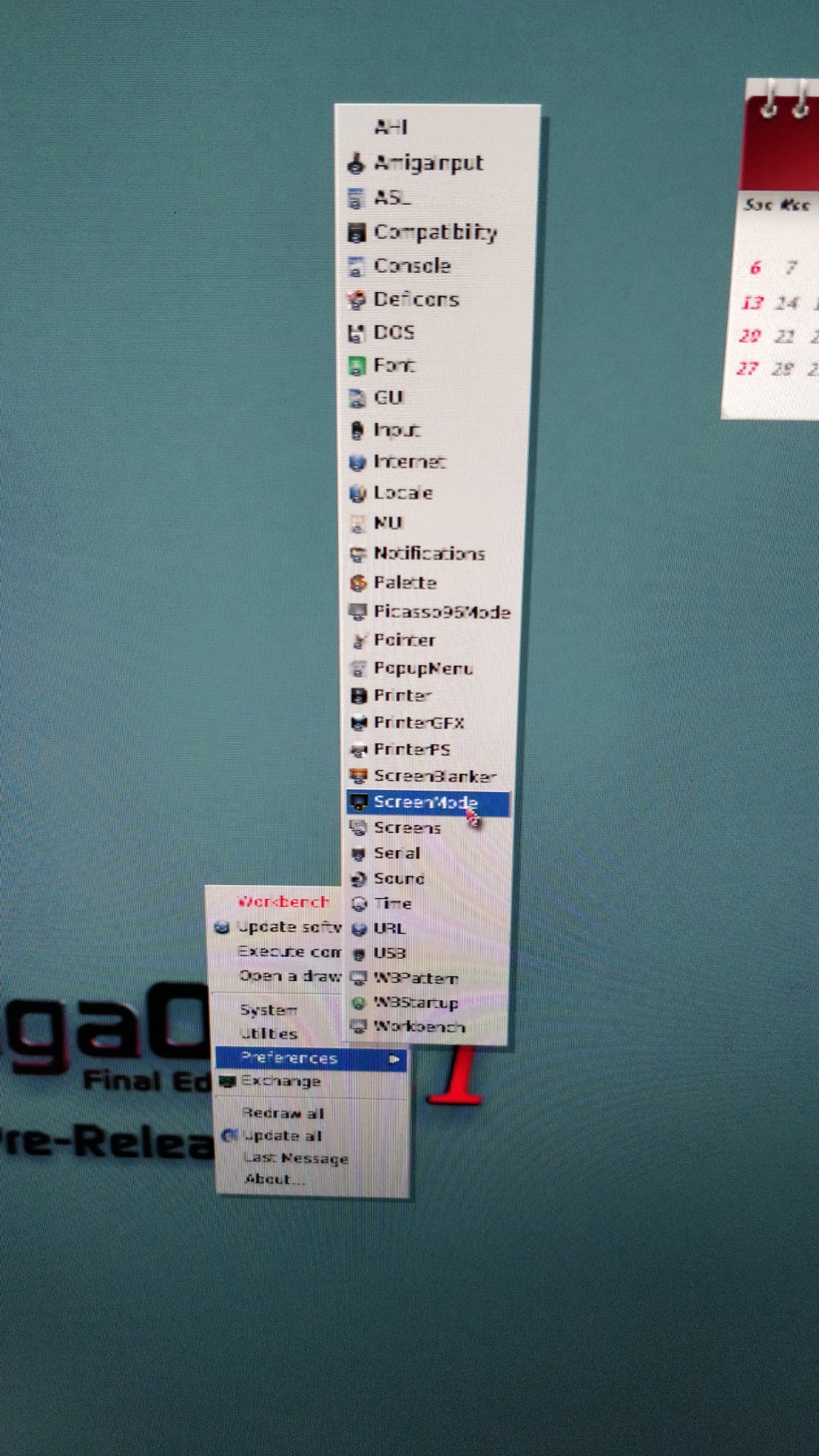

However if you look closely to the fonts on the screen in the 2560x1600 resolution they seem to be distorted somehow:
Right Click Menu
Right Click Menu

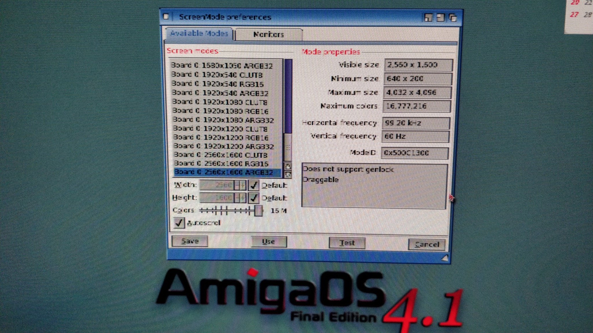

Once chosen (not while testing resolutions) for 2560x1600 in the ScreenMode menu I am not able to go back to 1920x1200. AmigaOS keeps on spamming me in a loop with an error that the screen mode cannot be set. Only a reboot is helping when this happens.
So in 1920x1200 the fonts look nice and readable, in 2560x1600 it gets almost unreadable as you can see in the screenmode preference menu:
ScreenMode Menu
ScreenMode Menu
So what is happening here?

It certainly looks like a bandwidth limitation to me. All the narrow vertical lines (high frequencies) are smeared or washed out, while horizontal lines (low frequencies) are OK. I would suspect the adaptor or cable, but you say it is OK with other OS? Really OK on fine text?
Perhaps the AmigaOS Radeon driver is trying to use the analogue parts of the DVI connector, while the other OS are using the digital and thus are able to use the full DL bandwidth. Dunno.
I notice that your H freq is very high - nearly 100 kHz. With 2560 pixels across the screen, that needs a bandwidth greater than (2560 x 100 k =) 256 MHz. That is pushing the bounds of the adaptor and cable, not to mention the specification of the DVI interface. Perhaps you need to attract Hans' attention.
