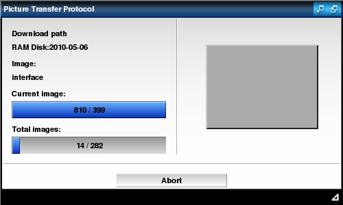

Picture Tool Protocol transfers pictures
gazelle wrote:The Lumina 520 should have "USB mass storage" support. Maybe you have to enable it somewhere?
You could start SYS:Utilities/USBInspector and take a look at what your Lumina is recognised (or take a look at T:usb.log).
Well, Lumia and IPhones are based on a Windows 8 environment, as it would seem, so that would probably mean these mobiles' functions are locked by the factory and won't work on other systems than Windows/MacOS X for x86. Sad, but true.
But a Picture Tool Protocol appears instead, like this one:
Helge Kvalheim, Norway
AmigaOne 500 @ 1.15Ghz Samsung SSD 840 EVO 500GB, AmigaOS 4.1 Final, 2GB DDR2, Sapphire Radeon HD 6670 1GB GDDR5 PCI-E, ESI@Juli XTe PCIe audio

HKvalhe wrote:But a Picture Tool Protocol appears instead, like this one:
So ... problem solved?
Yes, it would seem that way, as it deals with transfer of datas that can be pictures, videos or just files. So to understand, this is not a problem after all, but rather a limitation of the AmigaOS4 during support for mobiles, but then again, Lumia and IPhone are based on Windows, so these remain under the Microsoft policy.
Yes, the problem seems solved :) Found out about it with the Picture Transfer Protocol that appears :) Thanks, everybody! :)
