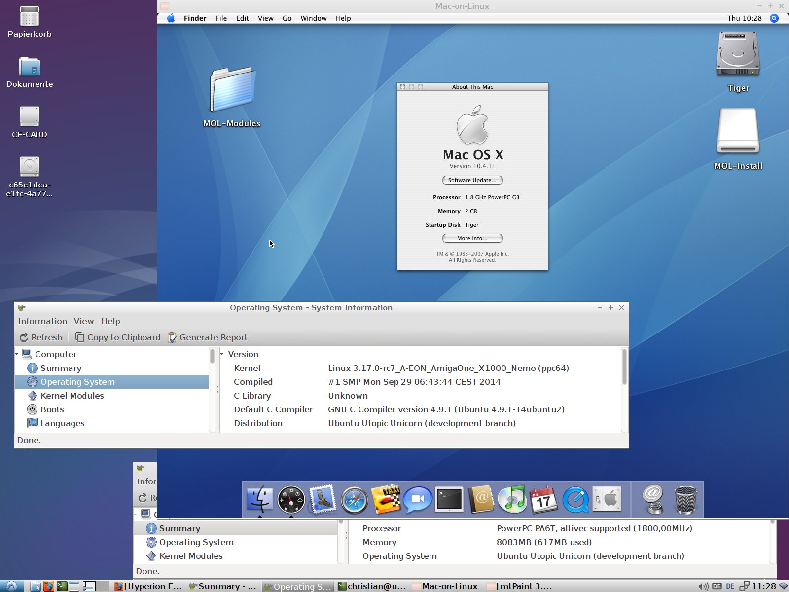

I have figured out, that Mac OS X only boots with the RC1 of kernel 3.17 or higher. Mac OS X doesn't boot with kernel 3.14 and 3.15. I could boot Mac OS X 10.3.4 Panther with the kernel 3.17 too.

I installed it on Ubuntu Remix 12.04 with th latest 3.17 kernel. However it will not start :-(
This is what I get:
benny@benny-X1000:~$ uname -a
Linux benny-X1000 3.17.0-rc7_A-EON_AmigaOne_X1000_Nemo #1 SMP Mon Sep 29 06:43:44 CEST 2014 ppc64 ppc64 ppc64 GNU/Linux
benny@benny-X1000:~$ startmol --osx
Mac-on-Linux 0.9.73-SVN [Apr 27 2014 19:21]
Copyright (C) 1997-2004 Samuel Rydh
Starting MOL session 1
KVM: Couldn't create VM
KVM init failed

You have to load the KVM-PR kernel module before you start MoL.
sudo modprobe kvm-pr
If you want, that the A-EON Live Remix distribution loads the kvm-pr kernel module automatically at boot time, then you have to add the line kvm-pr to the config file /etc/modules.
