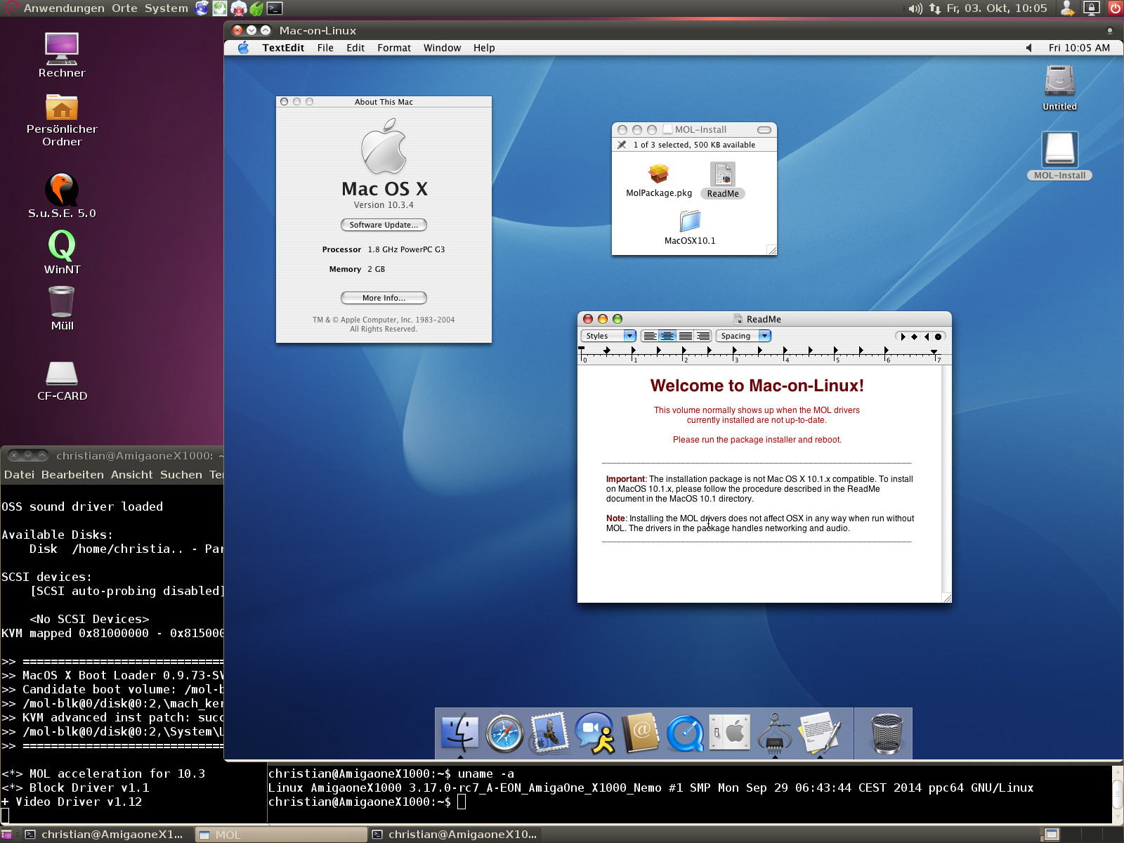

I have created a MoL/KVM deb package for these following systems:
  • A-EON Live Remix Distribution
  • Lubuntu 12.04
  • Lubuntu 14.10
Download: mol-kvm_0.9.73.0-ubuntu_powerpc.deb
If you want to allow normal accounts to run MoL through startmol script, you have to use dpkg-statoverride:
sudo dpkg-statoverride --update --add root root 4755 /usr/local/lib/mol/0.9.73/bin/mol
Re: Qemu
I have figured out, that Mac OS X only boots with the RC1 of kernel 3.17 or higher. Mac OS X doesn't boot with kernel 3.14 and 3.15. I could boot Mac OS X 10.3.4 Panther with the kernel 3.17 too.
