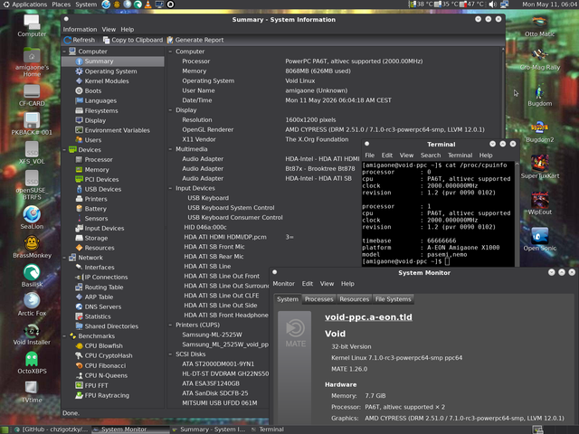

I tested the 6.12.84 on my Xenial but noticed a complaint from the sound driver listed below. I also tried to test the sounds from the Sound Preferences but the hardware doesn't show up. By comparison kernel 7.1.0-a3 under MATE works fine.
