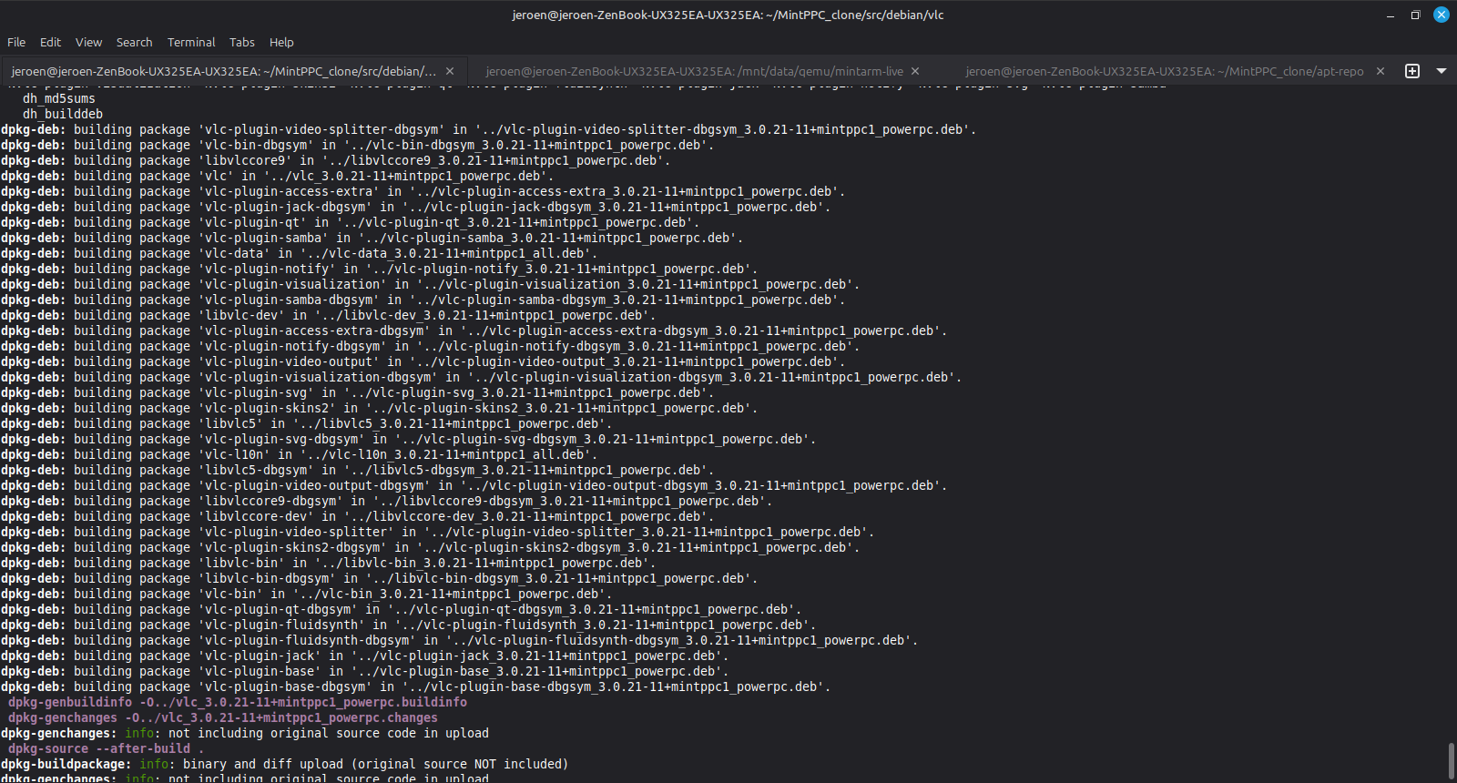

I will try to build a non-altivec vlc package.
edit1: it took me ages to get all build-deps in, but I have them now, they are installing in my sandboxed chroot (540 packages!)
edit2: configuring (see pic)
edit3: bad news:
input/input.c: In function 'InitTitle':
input/input.c:909:19: error: assignment to 'const input_title_t **' from incompatible pointer type 'input_title_t **' [-Wincompatible-pointer-types]
909 | priv->title = p_master->title;
make[5]: *** [Makefile:2708: input/input.lo] Error 1
make[5]: *** Waiting for unfinished jobs....
edit4: one last try with an even older vlc source package
edit5: one very last try with the latest vlc, I saw that non-altivec arches build, only powerpc didn't build. In the powerpc build log I see an error related to altivec. Maybe if I disable altivec in this version, it might build ....fingers crossed.

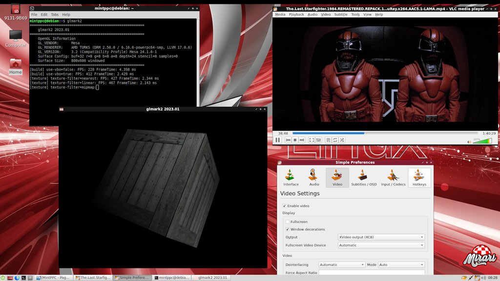

Posts: 11533
Re: MintPPC
xeno74 wrote: Mon Sep 15, 2025 7:54 am FYI: Hardware 3D acceleration doesn’t work currently (LLVM issue).
Maybe this helps: Downgrade mesa
The mesa script has solved the issue. Hardware 3D acceleration works! :-)

Post by mintppc »
I have a VLC build !!!
Posts: 11533
Re: MintPPC
mintppc wrote: Tue Sep 16, 2025 12:26 am I have a VLC build !!!
Great! Thank you! :-)

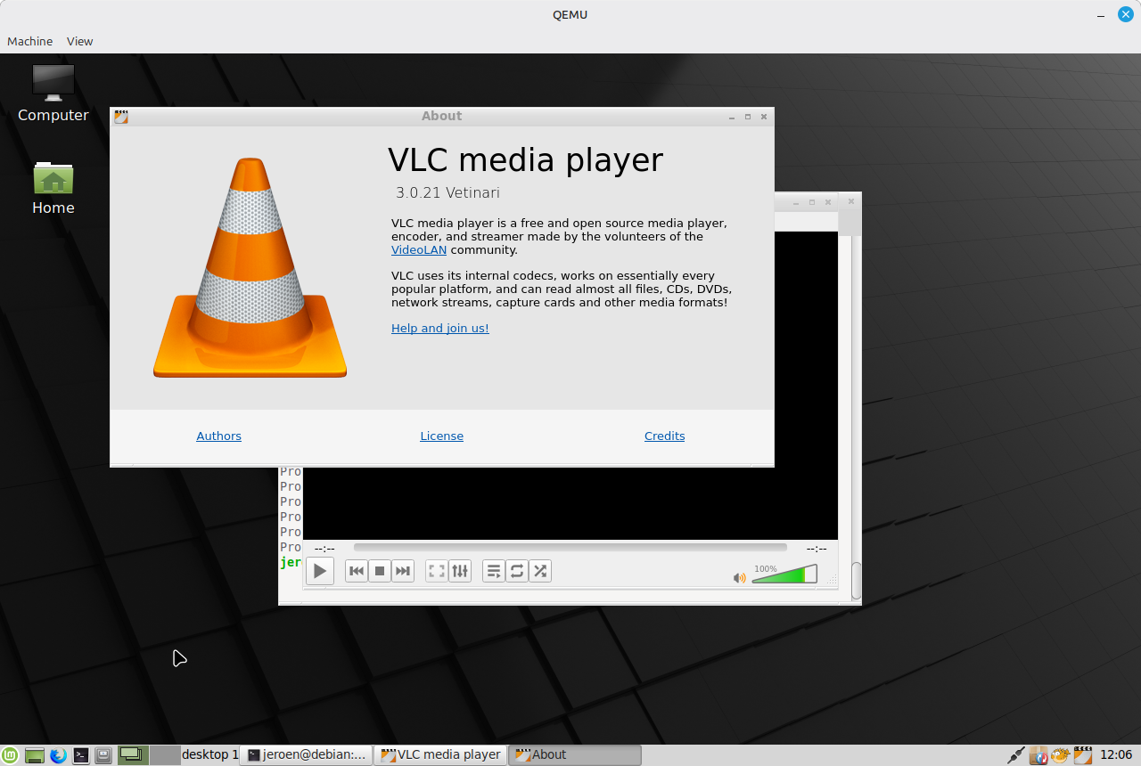

mintppc
Posts: 193
Re: MintPPC
Post by mintppc »
In QEMU on my machine VLC crashes when opening an mp4 file.
to install in MintPPC:
apt update
apt install vlc
Let me know if it works, I am curious.
