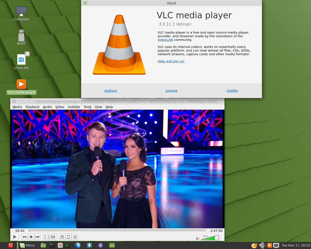

Now the VLC is working with X5000 in MintPPC! Jeroen Diederen (the author of MintPPC) kindly compiled a special non-altivec version of VLC 3.0.11.1 :-). Here is a link to the package: https://drive.google.com/file/d/1lgPdQO ... sp=sharing
I could also put available a customized MIntPPC partition image, after I have polished it - if there is interest?

Roland wrote: Tue Nov 17, 2020 9:14 am Now the VLC is working with X5000 in MintPPC! Jeroen Diederen (the author of MintPPC) kindly compiled a special non-altivec version of VLC 3.0.11.1 :-). Here is a link to the package: https://drive.google.com/file/d/1lgPdQO ... sp=sharing
Fantastic! :-)
Roland wrote: Tue Nov 17, 2020 9:14 am I could also put available a customized MIntPPC partition image, after I have polished it - if there is interest?
That would be great!
