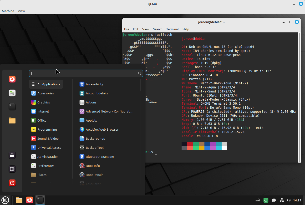

I have a working installation of LMDE 6 PPC with the cinnamon desktop now :) The only thing that needs to be done now is testing on real hardware, as I run this system in QEMU Power10. It is slow as hell.
