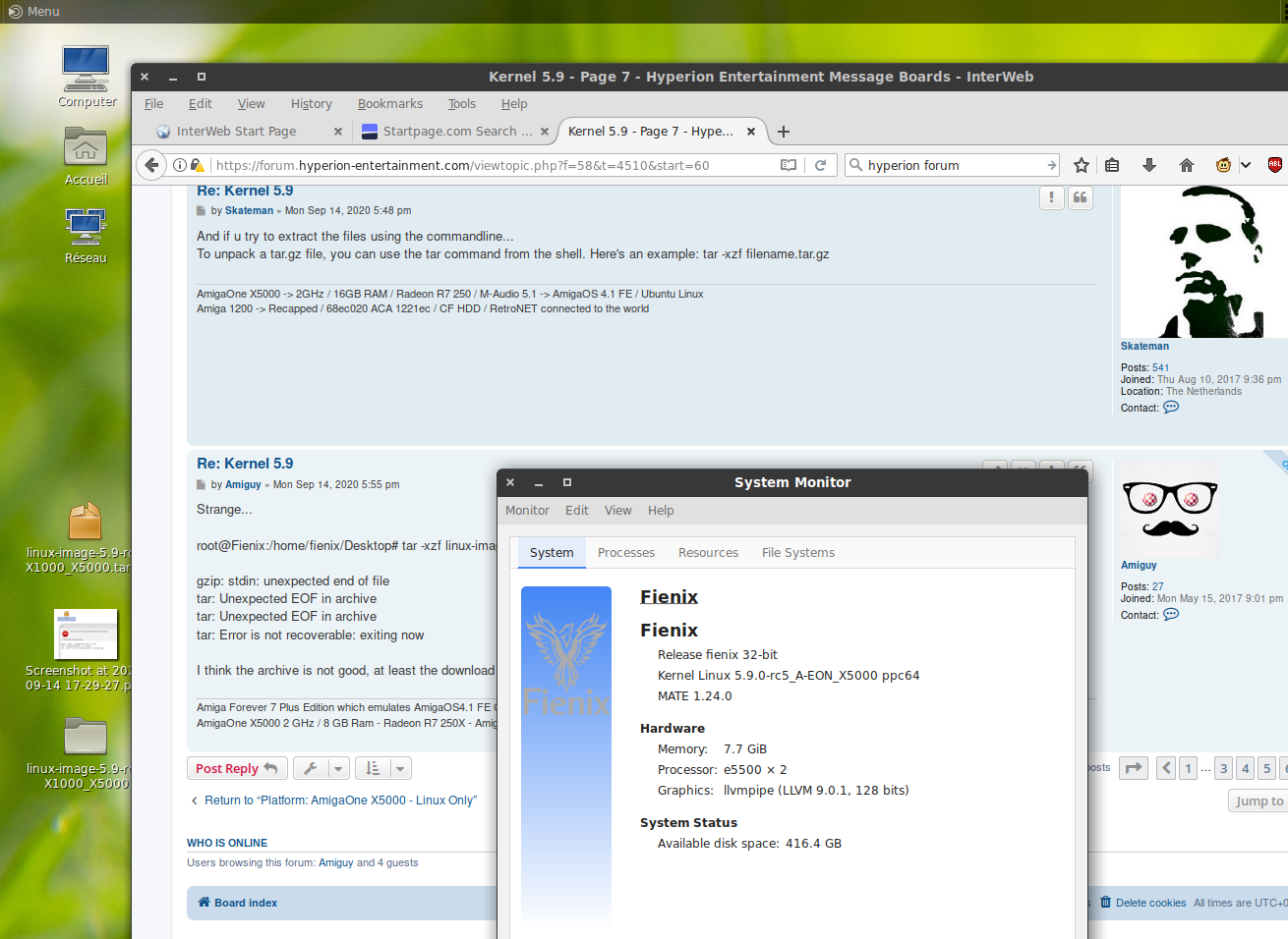

It works. The download was not good.
I noticed a red "FAILED" message when scrolling through the initial text that I never had before. Unable to read this message, it’s too fast. Is there a way to stop it to read or pause it?

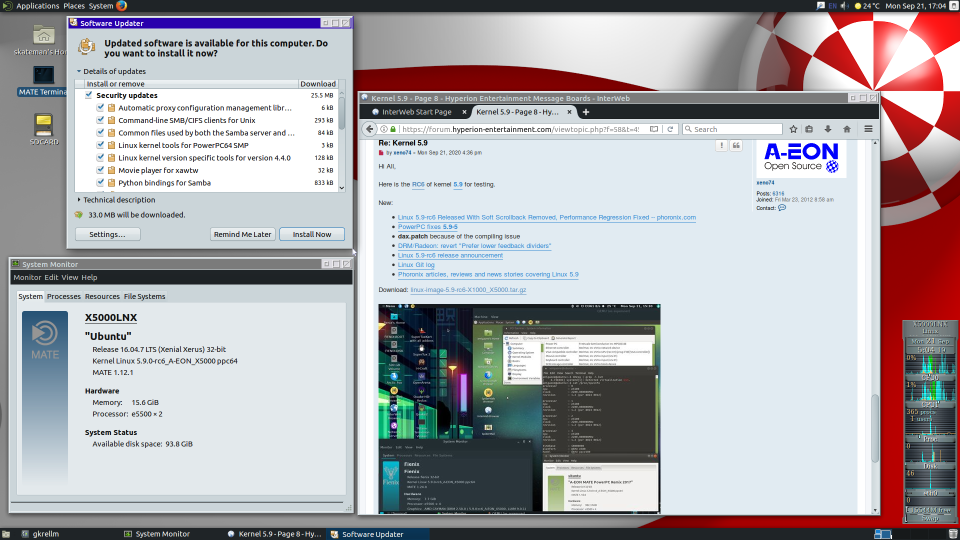

Re: Kernel 5.9
Kernel 5.9 RC6 is running fine on the AmigaOne X5000
Big picture: http://www.skateman.nl/wp-content/uploa ... 170419.png

Re: Kernel 5.9
rc6 works fine on my AmigaOne X5000 too! I did have to load the new modules and reboot, having forgotten that the modules are always changed too.
