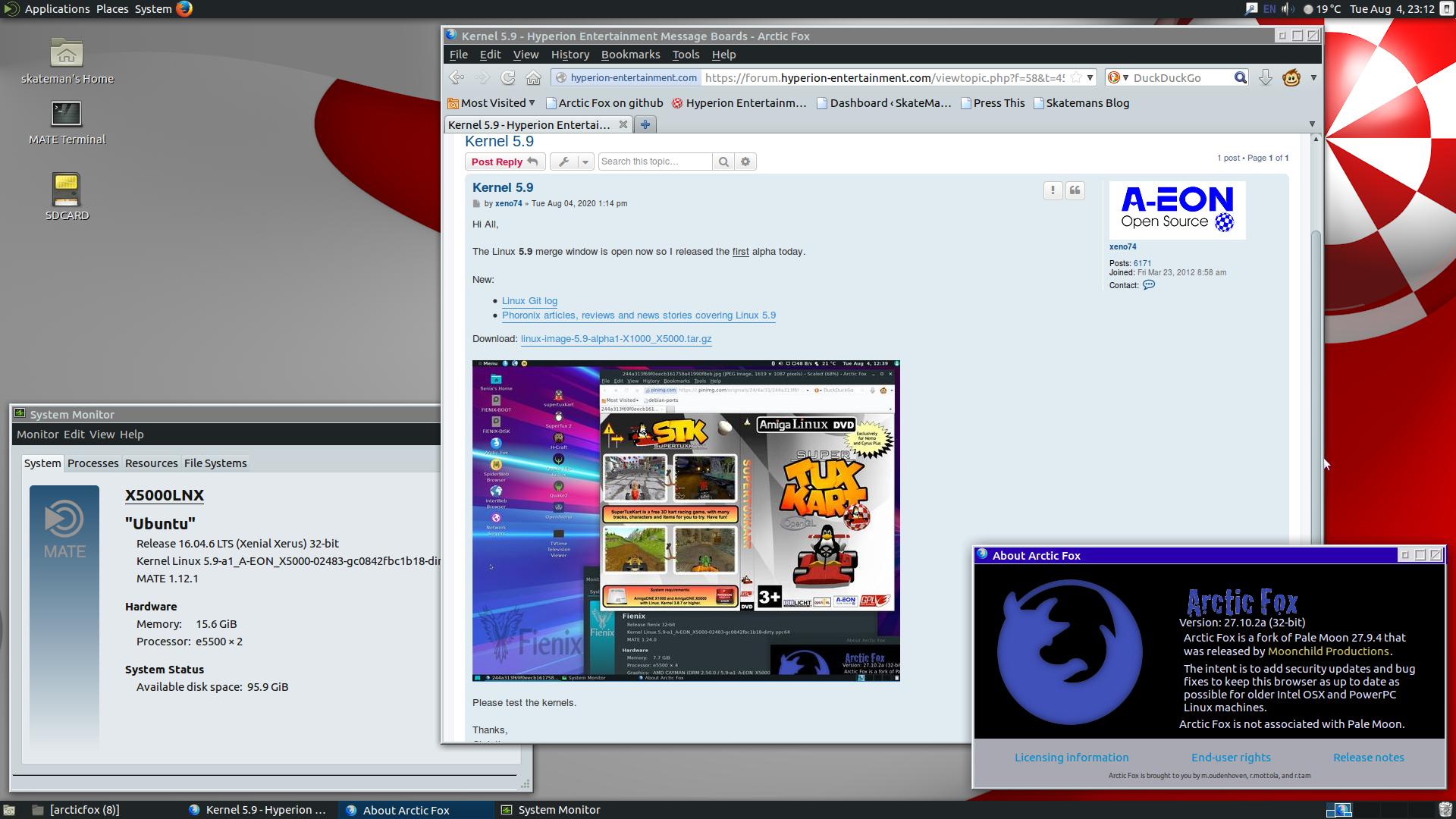

Kernel 5.9 Alpha1 running fine on my AmigaOne X5000. Also using the latest version of ArcticFox 27.10.2a
Big picture: http://www.skateman.nl/wp-content/uploa ... 231255.png
