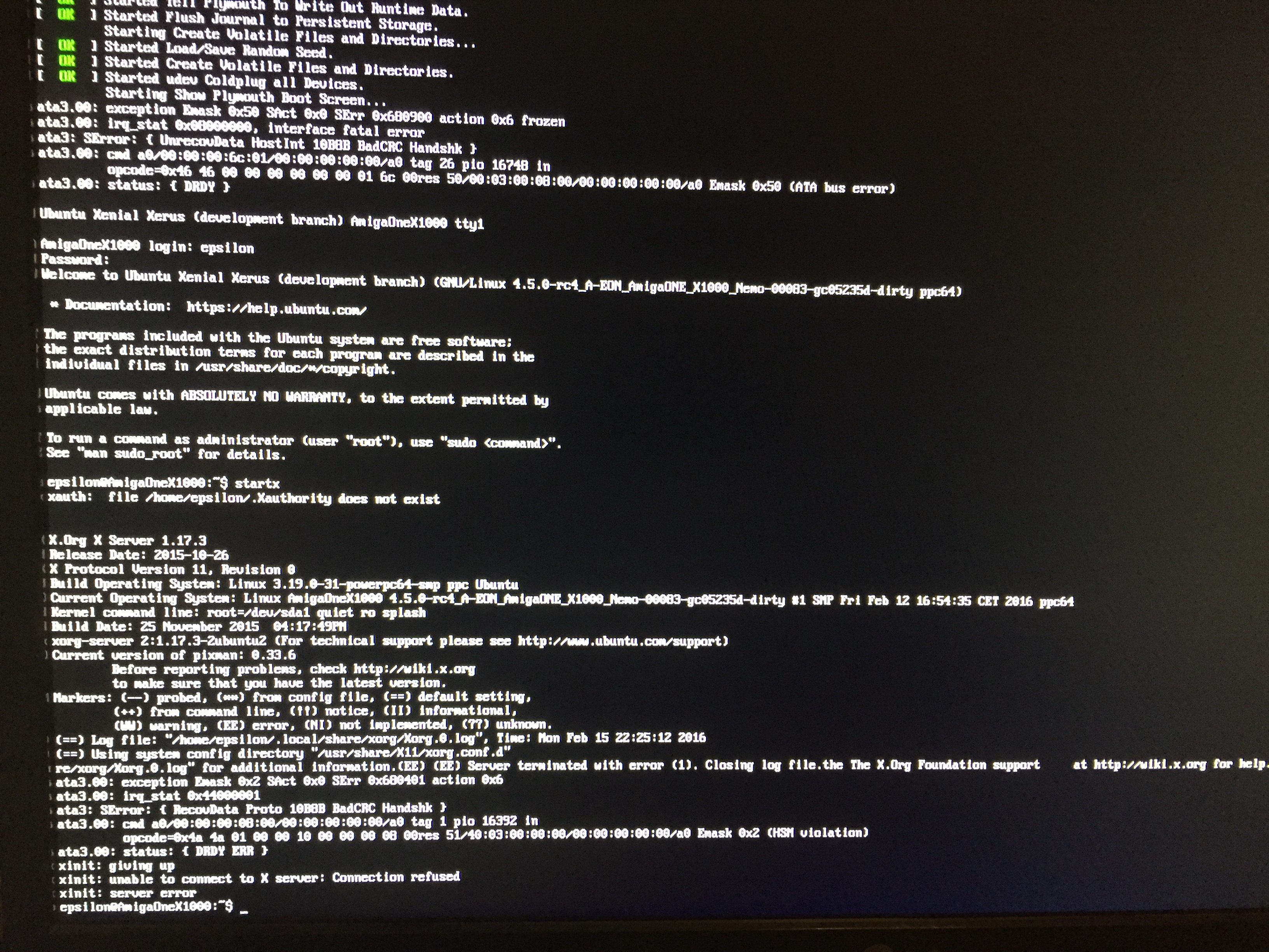

As an update I worked out the error message problem. It seems that even though I entered the bootargs parameter into cfe it had a different entry already and wasn't overwriting it.
I have sorted that, and linux boots to a point, but no x-windows loads up - just a flashing cursor in the top left off the screen. Note that I followed the instructions to install Standard, LUbuntu and XUbuntu desktops as per the working config mentioned.
Do I need anything else? I saw a patch file mentioned in this thread, do I need it and if so, where does it need to go?
I can get to the logon terminal as below. When I login and try to run x I get errors as below:
error running x-windows under ubuntu 16.04rc4
Any help appreciated.

Did you try Zappa's xorg.conf?
Epsilon
Posts: 30
Joined: Thu May 24, 2012 11:48 am
Post by Epsilon »
xeno74 wrote:Did you try Zappa's xorg.conf?
Yes I did and it worked - thank you. :-)

If X11 doesn't work after the installation then try zappa2009's xorg.conf files.
Download: X.org.conf.zip
Please rename xorg.conf.radeon to xorg.conf and then copy it to /etc/X11.
Good luck! :-)
