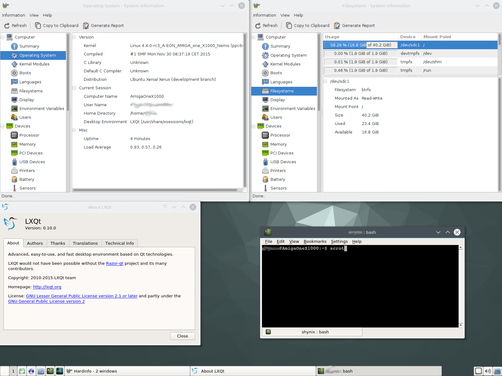

LXQt on LXDE core system on an Ubuntu Xenial 16.04 installation.
The partition is BTRFS on a MBR partition table.
Warning! LXQt is an experimental desktop based on LXDE and Razor-qt.
Graphics card: R9 270 (southern islands) which means radeonsi and no hardware acceleration.
LXQt uses by default Openbox. I changed it to Kwin and when hardware acceleration becomes available it can be changed to Kwin-wayland and have everything run on Wayland. Now if only they would fix it...
* I'm adding again the SMplayer gui which can use MPV instead of MPlayer for your convenience.
smplayer_14.9.0.7042-1~trusty1_powerpc.deb.bz2
(2.4 MiB) Downloaded 1534 times
