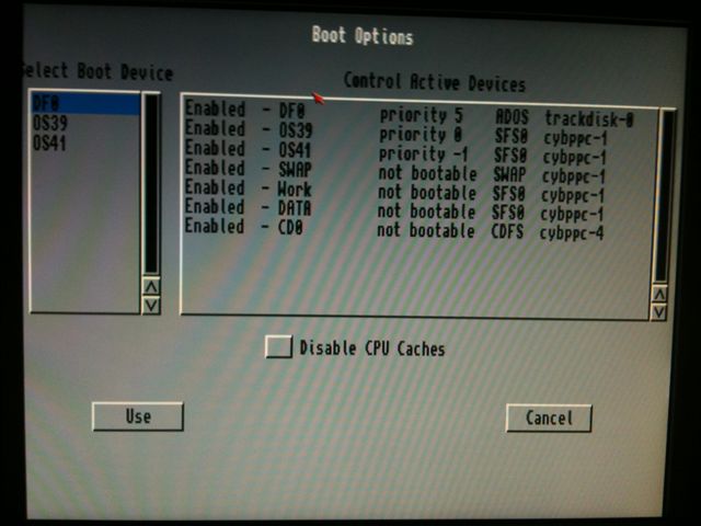

Can you double check your SCSI unit is turned on in the CS PPC menu? Hold down ESC at startup to get into the CS PPC menu, go into SCSI and make sure the unit's are turned on. Set everything to ON and Automatic.Fogg_80 wrote:My config:

Also check out my screenshots, the first one shows the cybppc controller with a couple of partitions and their boot priority.
If the the Unit # is turned off in the CS PPC menu (again hold down ESC at power-on to access it), your SCSI drives won't be available after you turn on your amiga, so make sure that the Unit # corresponding to your SCSI ID of your SCSI hard drive is turned on in the menu.
