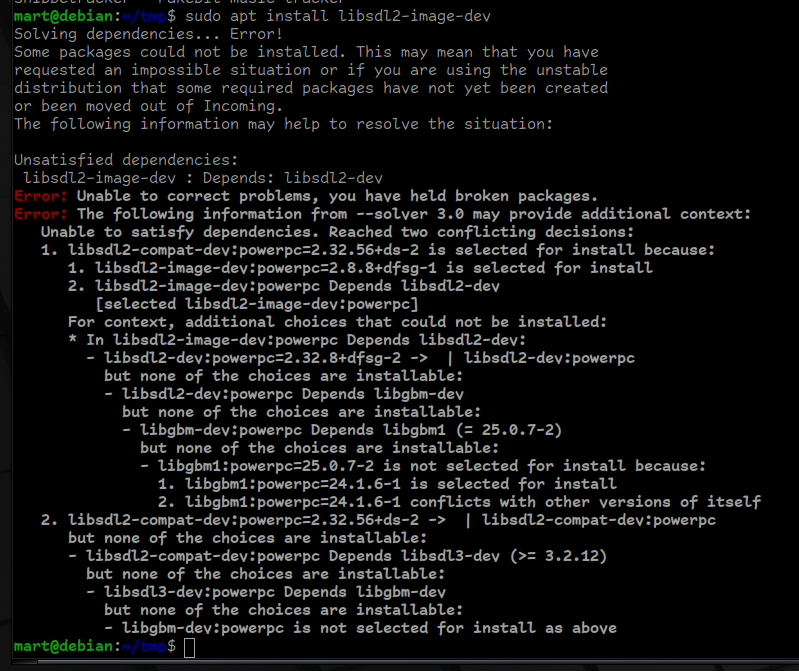

Can you give me the output in the terminal if you try to install those packages ?

Apologies that it's an image - it's from my capture card.
This is specifically when trying to install libsdl2-image-dev but it happens with any sdl2 related dev version of the lib - image, ttf, mixer.
I have since uninstalled the non-dev versions and then tried to install an explicit older version but every time I add a version number on the end of the package name I just get told that version wasn't found so I suppose I'm not doing something correct there. Maybe I need some different source to be able to go back in time with packages?
[edit] Bottom line - I think I need to specify the versions of the packages that pair with the version of libgbm that we've held back but I'm struggling to work out how to find out which version that might be.

I did it on my system. I found out what you need to do:
sudo apt install libgbm-dev=24.1.6-1 libgbm1=24.1.6-1
sudo apt install libsdl2-image-dev
