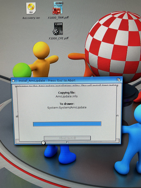

I’m having some issues trying to get AmiUpdate to update itself or even manually installing the latest version.
I’m on a X1000 with OS 4.1 Update 6 which was last used on November 2024.
My AmiUpdate version was 2.49. When I click on scan (active server www.amiupdate.net and the update.amigaos.net) it doesn’t offer any AmiUpdate updates (nor 3rd party updates).
If I manually try to install 2.55 it gets stuck just at the end
I then have to power down the X1000. After that AmiUpdate doesn’t launch again.

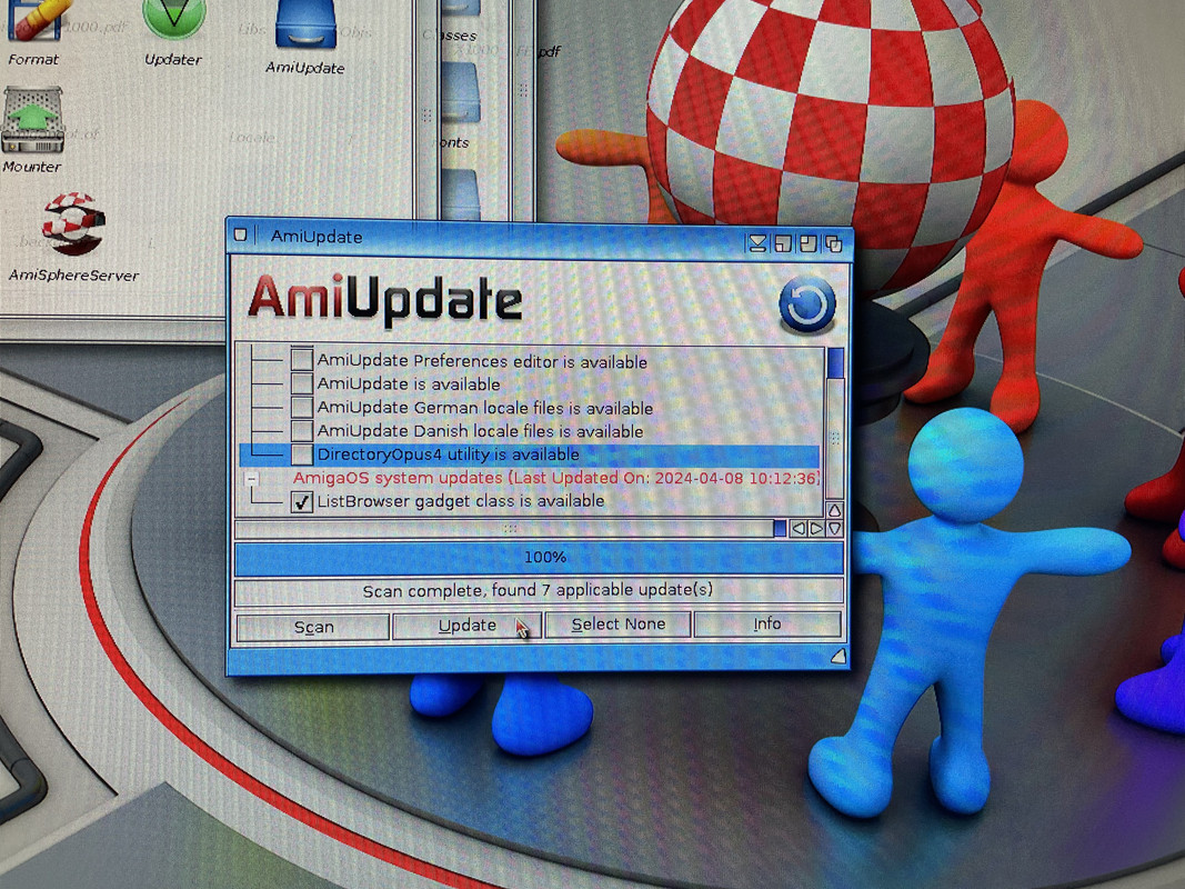

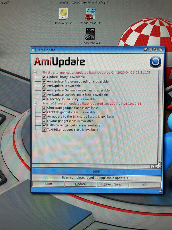

I’ve managed to get AmiUpdate to show the update and auto update: the trick was changing the server from amiupdate.net to codebench.co.uk/amiupdate_website
Then this is what appears as available updates:
If I select the update of AmiUpdate it will update but after reboot, a second after launching AmiUpdate the system will get stuck requiring a hard reboot. (I then manually install AmiUpdate 2.47 to gain back access to AmiUpdate)
Also, if I update listbrowser gadget, lot of apps won’t be able to start giving an error. (I’ve used rollback to go before those 6 OS updates, and now apps launch again)

emulajavi wrote: Thu Jun 05, 2025 4:34 pmI’ve managed to get AmiUpdate to show the update and auto update: the trick was changing the server from amiupdate.net to codebench.co.uk/amiupdate_website
I use www.amiupdate.net without problems (on AmiUpdate 2.55).
emulajavi wrote: Thu Jun 05, 2025 4:34 pmIf I select the update of AmiUpdate it will update but after reboot, a second after launching AmiUpdate the system will get stuck requiring a hard reboot. (I then manually install AmiUpdate 2.47 to gain back access to AmiUpdate)
The problem with some previous versions of AmiUpdate and self-updating is that it steps on its own toes trying to update a module (the library, I think) while it's in use. It should be okay after a reboot, i.e. you shouldn't have to go back to an older version - that's like going from the frying pan back into the fire :-). And the problem should be fixed with AmiUpdate 2.55, so it shouldn't happen again - if you stick to 2.55+, of course.
emulajavi wrote: Thu Jun 05, 2025 4:34 pmAlso, if I update listbrowser gadget, lot of apps won’t be able to start giving an error.
Could you please list (at least some of) the programs which won't start after the update?
emulajavi wrote: Thu Jun 05, 2025 4:34 pm(I’ve used rollback to go before those 6 OS updates, and now apps launch again
Why roll back them all if it's only listbrowser causing problems? Please try installing the others again to make sure that is the only issue.

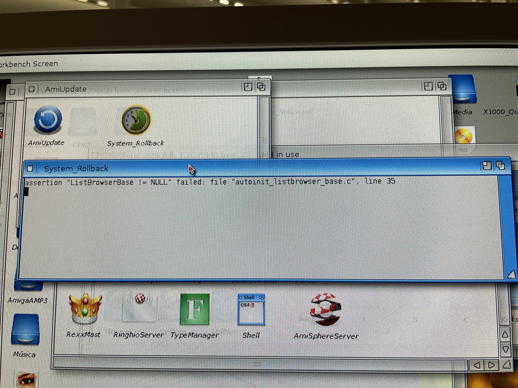

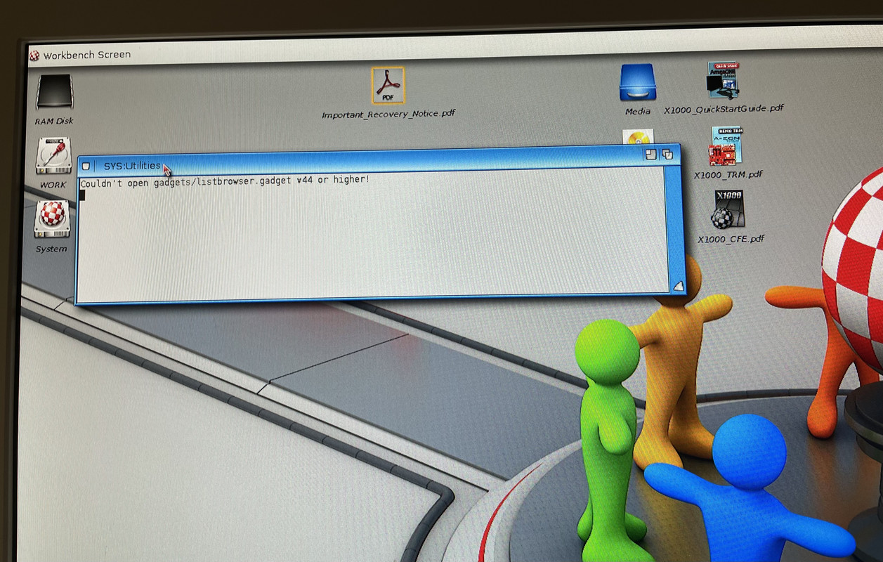

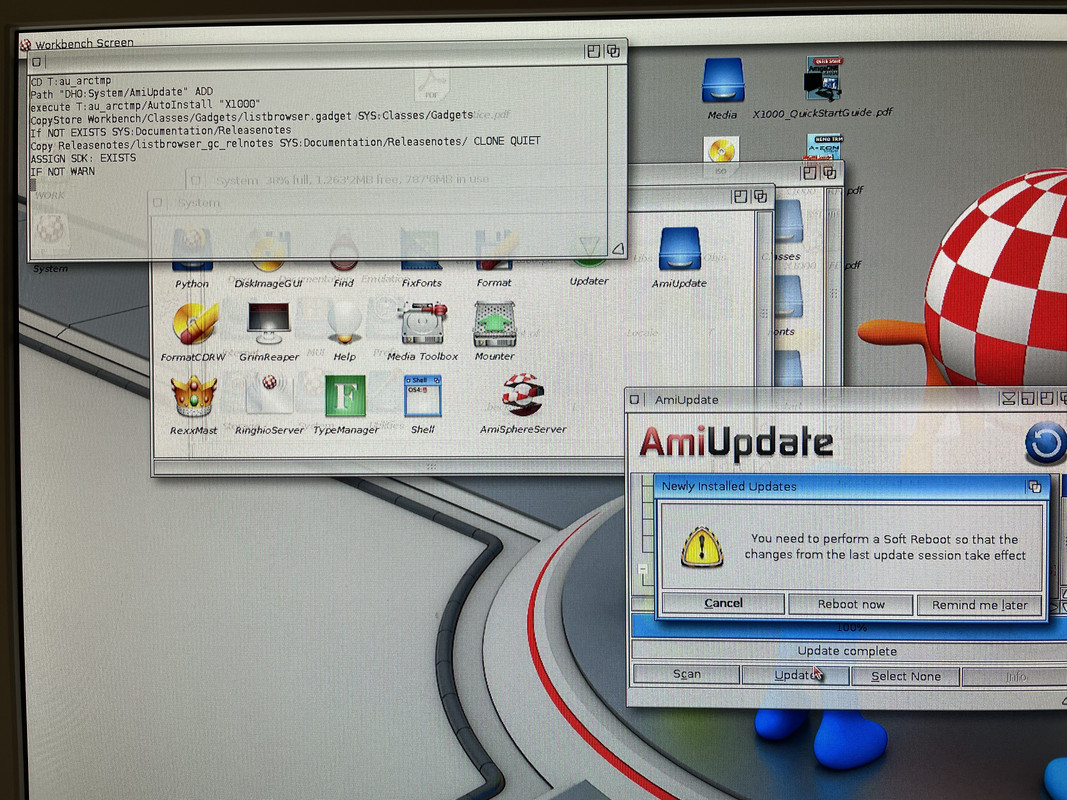

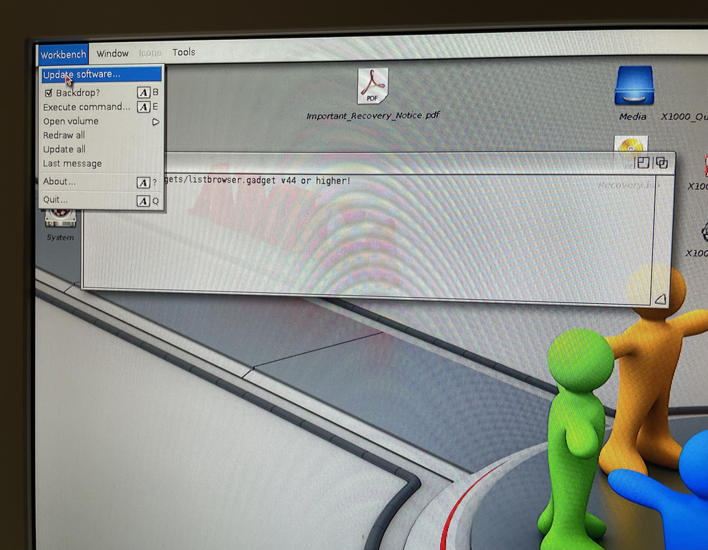

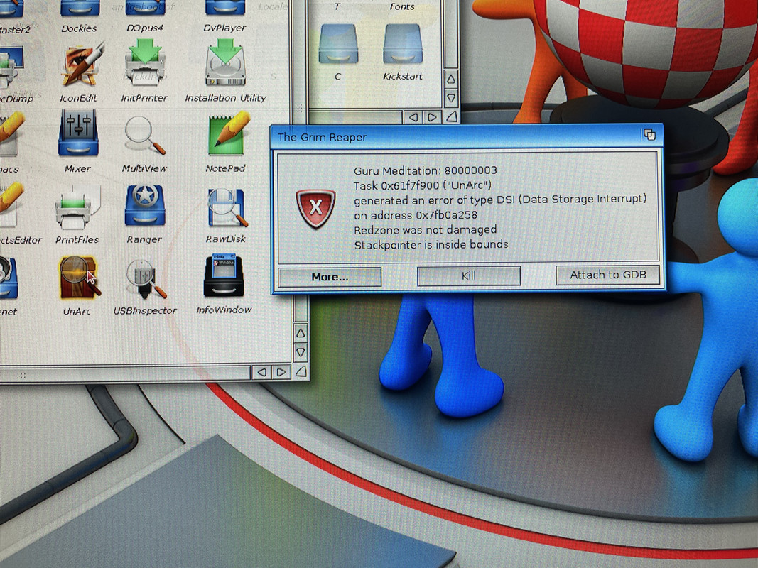

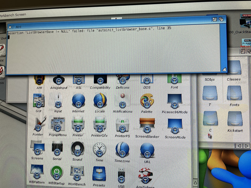

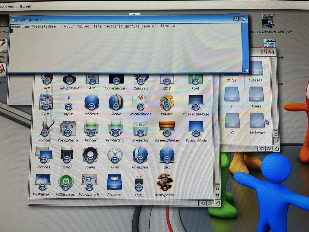

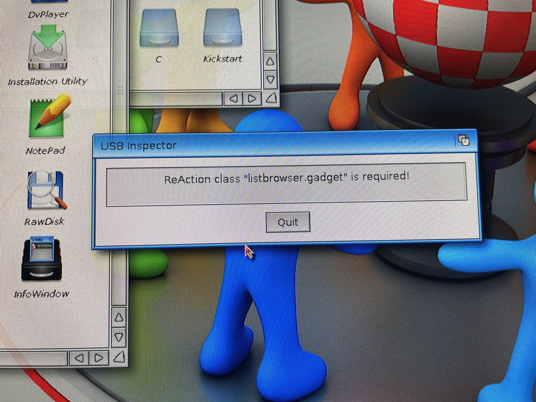

Just after updating the listbrowser.gadget and letting AmiUpdate perform the soft reboot…
- Desktop was back without the AmiDock on the bottom right. No matter if I reboot, the dock does not come back.
- Right clicking on the top bar on ‘update software’ does nothing. AmiUpdate won’t launch.
- Trying to open one of the .pdf of the desktop (that opened fine before the update) shows and error
- trying to open USB Inspector shows an error
- Trying to open UnArc shows an error
- Trying to open Prefs:AmiSphere shows an error
- Trying to open Prefs:AHI shows an error
- Trying to open System_Rollback shows an error
- AmiStore opens fine.

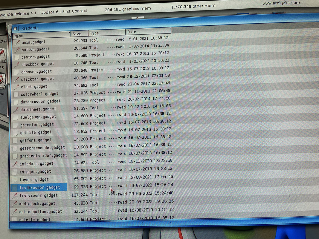

Just by placing on SYS:Classes/Gadgets/ the old listbrowser.gadget (size 95.460 date 2013) and Ctrl+LAmiga+RAmiga to reboot AmigaOS, AmiDock appears again and all those apps launch fine.
So it seems that the updated listbrowser.gadget (size 99.936 date 2022) that AmiUpdate installs, breaks it all on my system. Maybe this new listbrowser.gadget depends on other file(s) to also be updated to work well?
listbrowser.gadget as only update selected
update installed, just before soft rebooting
after reboot, desktop without AmiDock
error trying to open one .pdf
update software… does nothing. AmiUpdate doesn’t appear
error trying to open USB inspector
error trying to open UnArc
error trying to open AmiSphere
error trying to open AHI
error trying to open System_Rollback
listbrowser installed by AmiUpdate (size 99 and date 2022)
old listbrowser before updating (size 95 and date 2013)
Thank you!

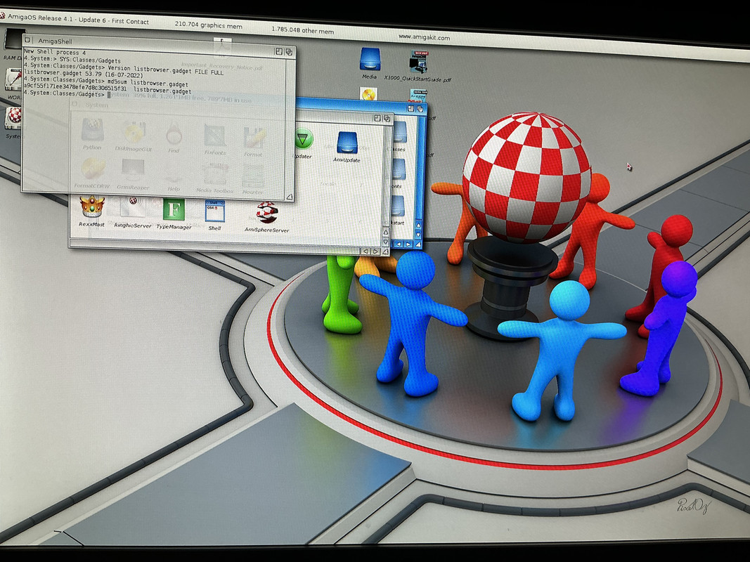

nbache
Posts: 1759
Re: AmiUpdate not autoupdating
Post by nbache »
This looks strange.
The first thing that comes to mind it that somehow you've got a damaged listbrowser.gadget with the update, although I can't see why this would happen to you and not everybody.
Still, it's a possibility.
Try, wiht the new listbrowser.gadget installed, to open a Shell and enter "SYS:Classes/Gadgets" (without the quotes, of course). Then enter:
Version listbrowser.gadget FILE FULL
- you should get:
listbrowser.gadget 53.79 (16/07-2022)
Then enter:
md5sum listbrowser.gadget
- you should get:
a9cf55f171ee3478efe7d8c306515f31 listbrowser.gadget
For now, let's see what happens with those checks.
And BTW, did you go back to the newest AmiUpdate again? I don't necessarily trust that things are installed correctly with the older ones, so please make sure you're on 2.55.
emulajavi
Posts: 17
Joined: Fri Nov 15, 2013 1:06 pm
Post by emulajavi »
Hi,
Thank you for your reply
The file seems to be fine
Although the file is there (with the same exact name as the old version) it’s like the applications that rely on it aren’t able to use it, so AmiDock doesn’t appear, AmiUpdate doesn’t launch, etc
Is there anywhere a log file that can show what can be preventing AmiDock for launching?

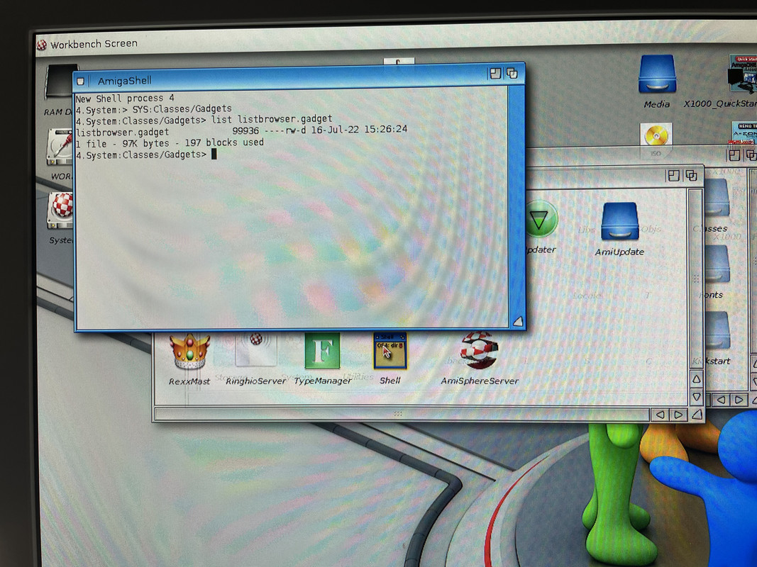

Oh, one more thing. Could you try doing a
list listbrowser.gadget
in the SYS:Classes/Gadgets dir? It will show whether for some reason e.g. the R bit has been reset on the new file.
Here, I see:
listbrowser.gadget 99936 ----rw-d 16-Jul-22 15:26:24

nbache wrote: Fri Jun 06, 2025 10:35 am
Here, I see:
Hi Niels,
Thank you.
The output is the same as yours. One other thing I’ve tested is to rename listbrowser.gadget to something else, to see what happens if the file listbrowser.gadget is not present inside the gadgets folder. And the applications give the exact same error as before.

Oh, darn. I should have read your very first post more carefully.
So you're not even on FE? I had missed that.
In that case, forget everything I've written. Those updates don't apply to the older OS version.
And please, yes, do get, install and register FE, and then the updates to FE (update 1 should be installed manually, without using AmiUpdate).
I just don't understand how AmiUpdate (even an older version) could list those updates for you at all if you're on an older, not supported OS.
emulajavi
Posts: 17
Post by emulajavi »
nbache wrote: Fri Jun 06, 2025 4:35 pm Those updates don't apply to the older OS version.
I have now made rollback of the 6 updates, installed back AmiUpdate 2.47, ordered a 4.1 FE copy for X1000, and once it arrives I will install it.
AmiUpdate offering those upgrades (certainly the listbrowser.gadget one and I don’t know if any of the other 5 could or not have any compatibility issues) for OS 4.1 Update 6… is what has caused the issues. Also, at least for me, AmiUpdate 2.55 might be incompatible with OS 4.1 Update 6.
Anyway… when they released 4.1 FE, they should have call it 4.2, to avoid confusion between OS 4.1 Update X and OS 4.1 FE Update X
Thank you very much for your help.
