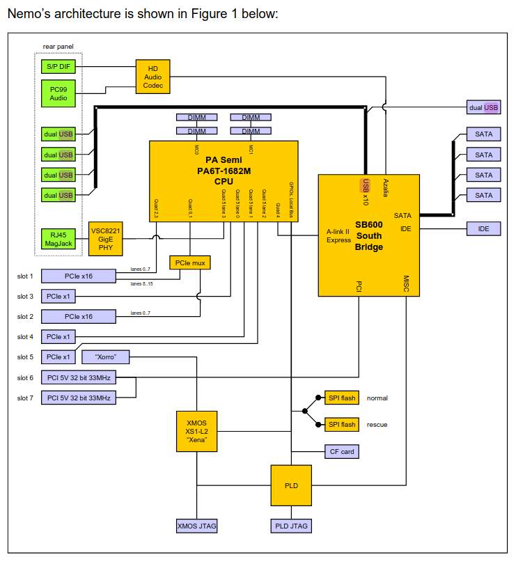

xeno74 wrote: Wed Feb 12, 2025 10:30 am Hi All,
Where is the connector for USB2 (EHCI) on the Nemo board?
That should be all the connectors at the back. And the front headers should be the same. According to the X1000 TRM at section 2.3 South Bridge:
  • multiple USB ports
  • 5 OHCI and 1 EHCI host controllers
  • all ports are fully USB 1.1 and USB 2.0 compliant
I have had trouble connecting my case to front port headers. Only one works for me if I plug it into a back port. I have a printer and keyboard plugged in through the back and usually use USB sticks in my front port.

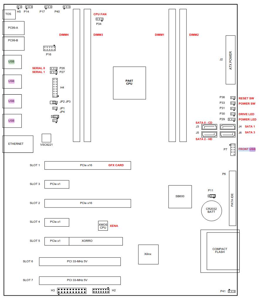

All ten USB ports are USB2.0, and are connected to SB600.
As I know, there is no other USB controller except SB600.
Image.
Firmware recognizes only one port: USB keyboard MUST be connected to the lower USB port closest to the Audio ports. I have USB hub connected to this first port for flash+kayboard.
8 ports are in back and 2 ports have header on motherboard.
Position of USB header on motherboard is P7.
I am normally using both front (P7) ports, it works normally.

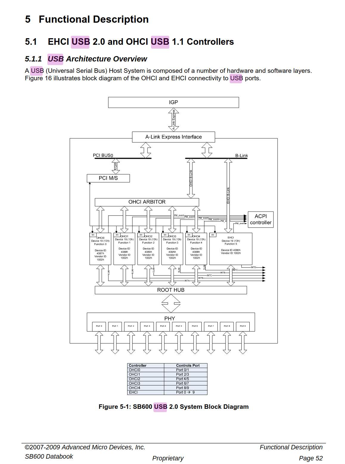

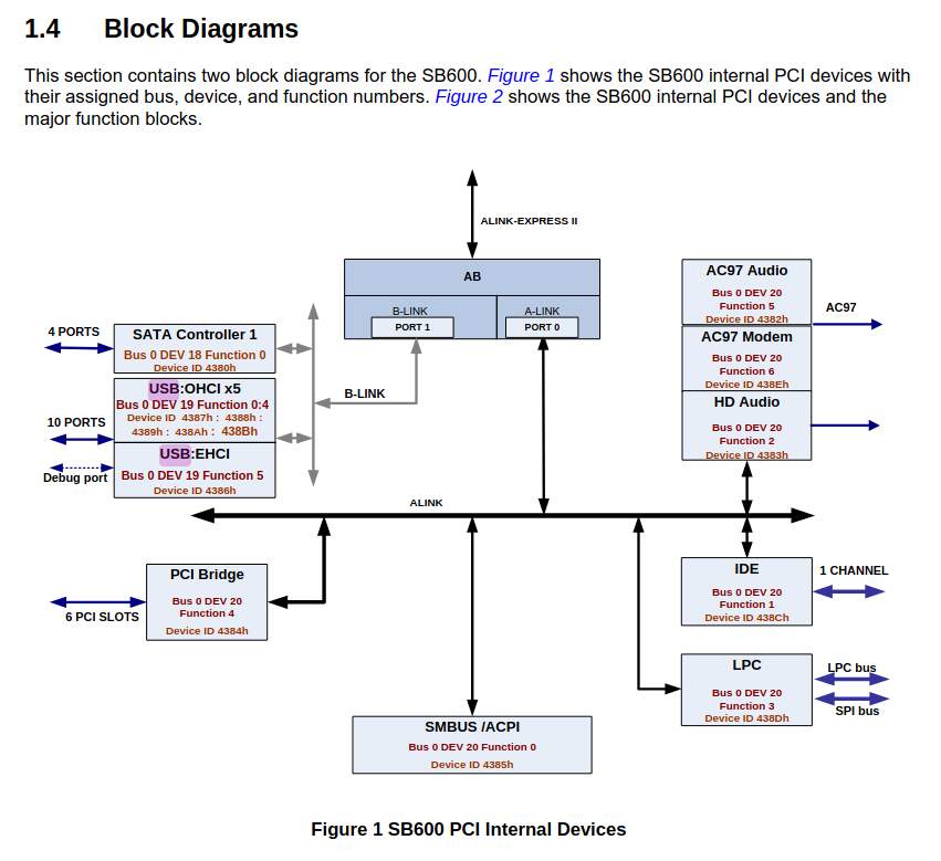

xeno74 wrote: Wed Feb 19, 2025 12:51 pm You're right because of the USB2 connectors but actually there are only USB 1.1 interfaces (OHCI) with 12 Mbit/s.
There is one real USB 2.0 interface (EHCI) from SB600 with 480 Mbit/s but it seems it is not connected to a USB socket.
Hi xeno74,
You are right - According to AMD SB600 Register Reference Manual there is 5xUSB OHCI internal PCI devices and one (debug port) EHCI device
But also according to SB600 Databook this devices are connected to PHY though root hub, and all physical ports should be EHCI capable.
In real with linux I have USB3.0 PCIe card connected to front panel, but I can measure motherboard port speed at home - probably next week.

sailorMH wrote: Wed Feb 19, 2025 1:34 pm
Wow, lots of great info, including extra diagrams. Some I had missed in the TRM guide. Well, that trumps the reply I gave! :-P

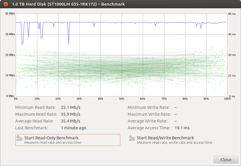

I bench marked my USB3 HDD connected to USB2 port on X1000 and get good speeds! :-)
