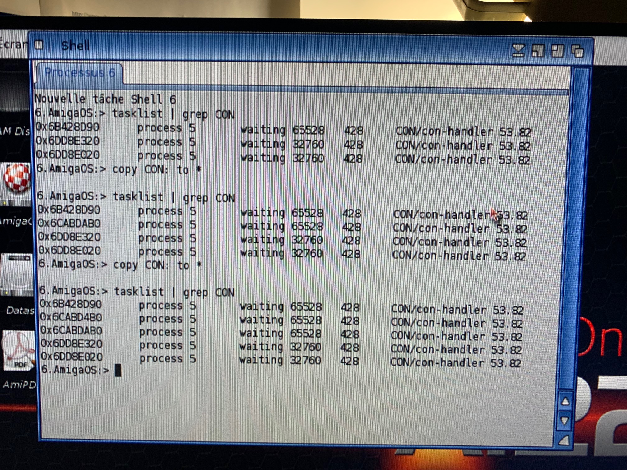

When running this AmigaDOS command under the AmigaShell there’s an issue a Con-handler process remains and is not closed? ( show with: tasklist | grep CON ) :
Copy CON: to *
Here is a screenshot of copy with con-handler process that remains:
This is with:
AmigaOS4.1FEu2(A1222)
Copy 54.11
Con-handler 53.82 (11.02.2018)
Console.device 53.120 (14.12.2023)
It works Ok with:
AmigaOS4.1FEu0
Copy 53.6
Con-handler 53.72 (3.10.2014)
Console.device 53.83 (1.10.2014)
Also, it is Ok with "
Type CON: to *
" in both cases.
Perhaps, it is only the copy program which lacks to close a handle?
Sincerely your,
DGILLES

There is no "c:Copy" version of 54.?? yet.
The latest beta tester version is; Copy 53.13 (12/08/2020)
I know, because I added the entry in the releasenotes;
Copy 53.13 (12.08.2020) <cjw>
- The buffer=0 option now checks for the largest block of memory and limits
itself to half of that, or 2gig, if the file size happens to be larger.
Can't repeat the issue with the latest components on test.
