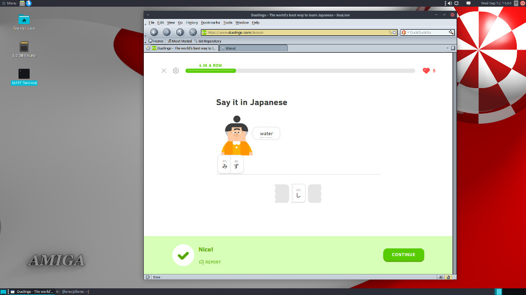

I have tested DuoLingo on my X5000 using Fienix and Sealion browser.
The initial loading of DuoLingo takes a while but its fully functional with speech.
Big picture https://www.skateman.nl/wp-content/uplo ... -04-22.png
Hope this helps.
Hope this helps.
