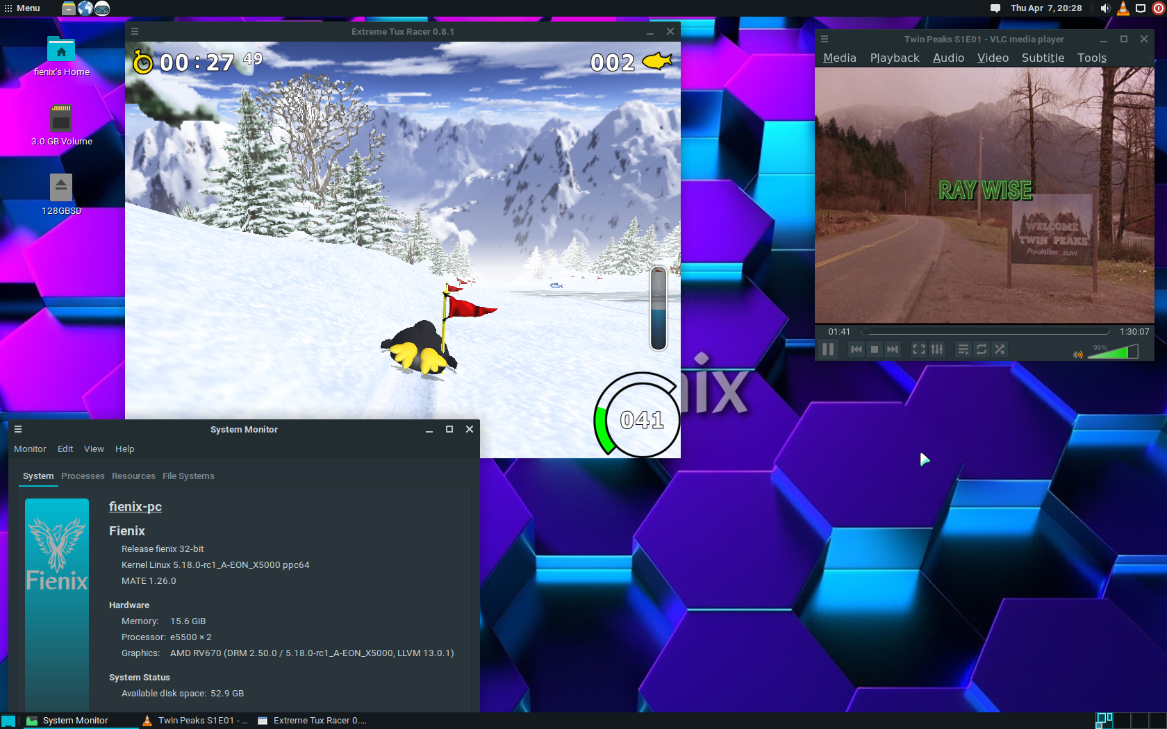

Fienix 5.1 Spark up and running on my AmigaOne X5000/20
Playing around a bit and so far.....its just GREAT!!!!!
Thanks so much Casey. Keep up the good work
big picture: https://www.skateman.nl/wp-content/uplo ... -28-40.png
