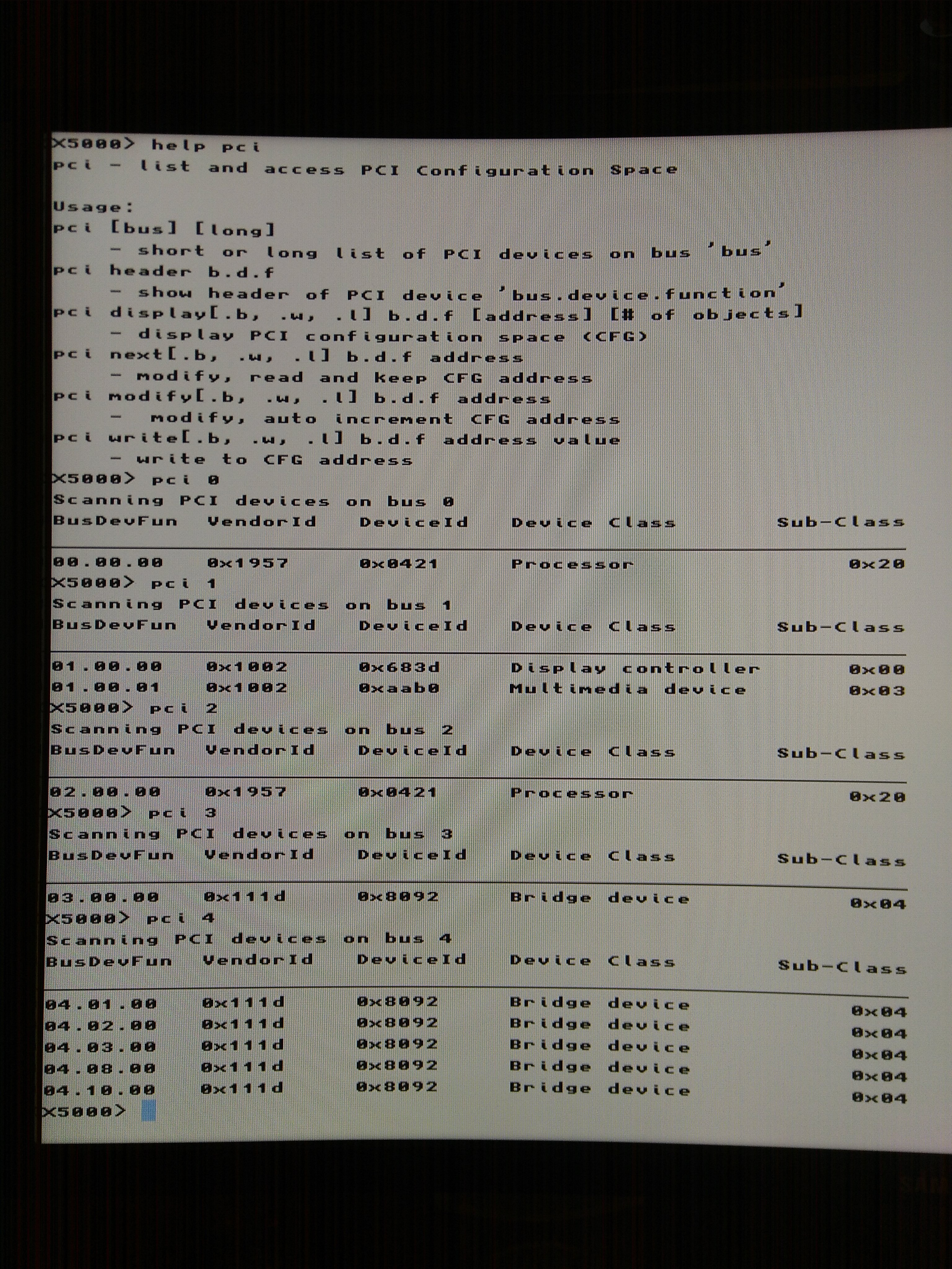

When we try to understand the UBoot variables, in particular the pci variable, we understand that any pci port is identified by an identifier code. As with the identification of the sata ports, it should be possible to boot an SSD disk from a correctly identified pci port.
The problem now is to know which port of my pci device corresponds to the correct identifier detected by UBoot. In my case, my sii3512 device has two pci ports. I deduce that my pci device is assigned to bus 1 which is the only one to have the two ports of my sii3512 device, identified respectively 0x683d and 0xaab0.
I wouldn't want to do any damage and would prefer to have confirmation of my reasoning...

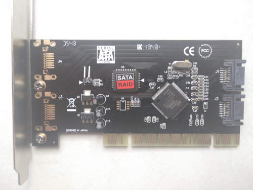

Thank you for considering my question. There is surely something obvious that I do not understand. Let's try to see things more clearly...
My goal is to connect a Linux SSD drive to one of the ports on my PCI card and boot the Linux kernel from my card. The PCI card is connected to the motherboard via a port marked "PCI 1". This card has two connection ports marked "J1" and "J2" (see photo).
When I use one of the ports on the motherboard marked SATA0 (the other is marked SATA1), I run Linux boot via the commands :
X5000> setenv linuxboot 'setenv bootargs root=/dev/sda2 ; load sata 0:1 1000000 uImage-4.18 ; load sata 0:1 2000000 cyrus.dtb ; bootm 1000000 - 2000000'
X5000> run linuxboot
But if I want to boot from the PCI card and assume that my "load sata 0:1" instruction is for the SATA port on my motherboard, what would be the instructions for the PCI card?
