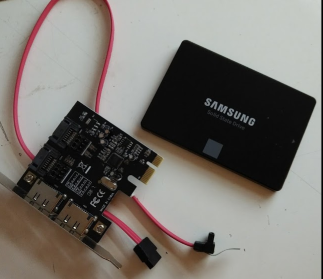

I bought myself a cheap asmedia sata controller and attached an SSD for running Linux.

The controller is ordered. I will get back to you as soon as it is assembled and tested.

Thanks for putting me on the trail. Thanks to your suggestions, I can now start linux and the Amiga without disconnecting anything and without a USB key. I did not fully understand how the startup of the two systems works.
Initially, I relied on two tips: ... but, indeed, I had not tried booting the Linux SSD on the motherboard sata port, while the second sata port was occupied by the Amiga SSD.
My configuration is therefore the following:
I have two Amiga SSDs and one Linux SSD. The Amiga SSD which contains the kikstart files is connected to the sata1 port. The Linux SSD drive is connected to the sata0 port. The third Amiga SSD drive is attached to the controller board.
The Linux SSD drive is divided into two partitions. A boot partition, named FIENIX-BOOT, and a partition containing the filesystem, named FIENIX-DISK. The boot instructions, when I select Linux boot from the U-Boot menu, allow me to boot from the partition of the FIENIX-BOOT Linux SSD drive.
My booting instructions are as follows:
X5000> setenv linuxboot 'setenv bootargs root=/dev/sda2 ; load sata 1:1 1000000 uImage-5.8 ; load sata 1:1 2000000 cyrus-p5040.dtb ; bootm 1000000 - 2000000'
I therefore confirm that it is not absolutely necessary to start from a USB key. Booting from SSD seems more elegant to me and works.
@Skateman : I have an unused controller for sale. If you're interested ... (just kidding :lol: )
Thanks guys for your help ;)

I have my system setup with onboard sata0 AmigaOS4.1 onboard sata1 Fienix-Linux (disconnected the optical drive) PCIe x1 Controller Sata Ubuntu Mate
I have every SSD drive dedicated voor the OS installed.
