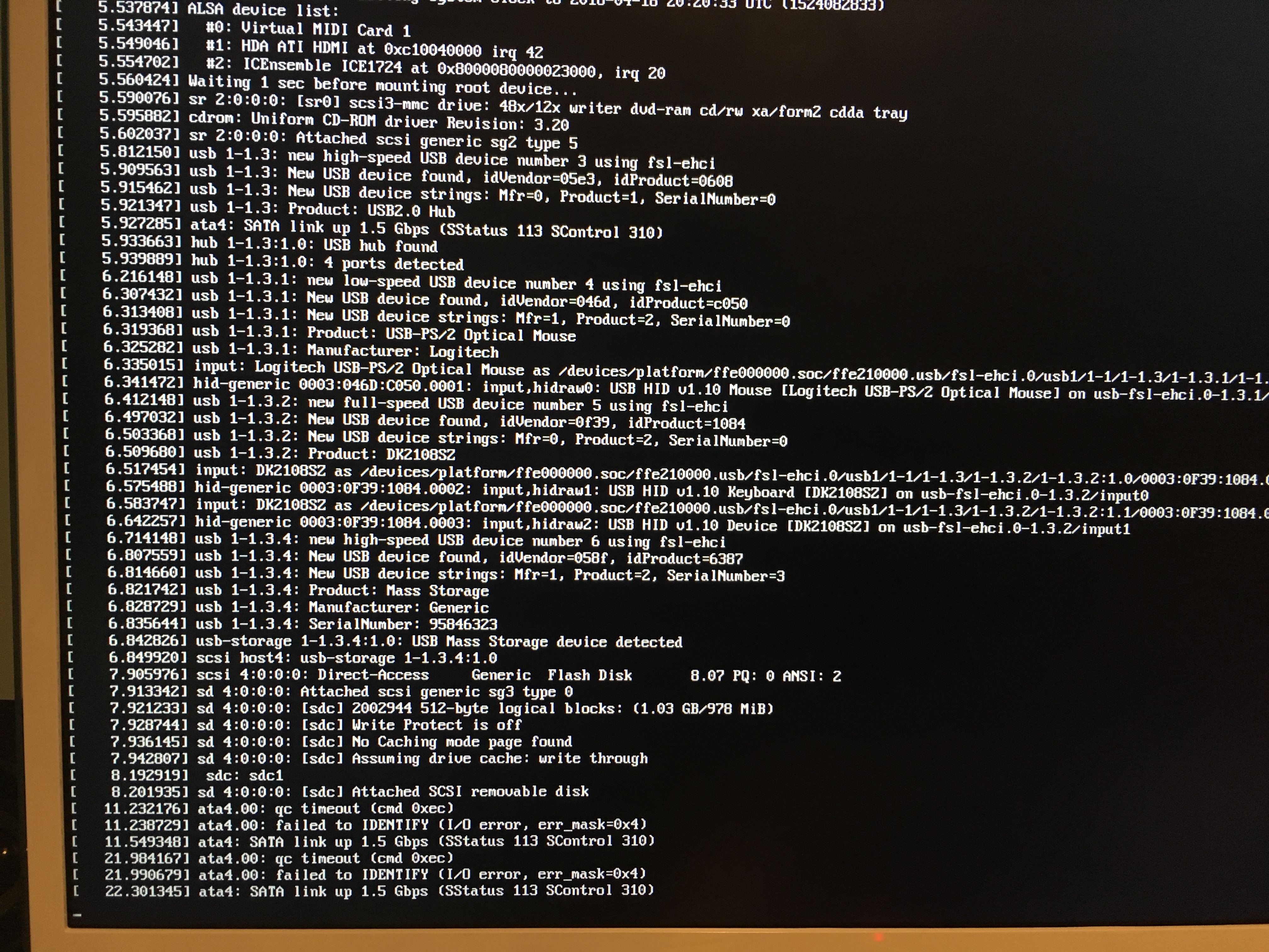

I have no problem running this from a usb stick, however I from looking at the startup sequence something is not being recognised if someone can advise what the attached means.
Basically when the hard disk is installed the drive is sdc1 but when it picks up sdc1 here this is referring to a USB key I have in with the Linux installer files it’s like it’s not seeing the drive connected to the sata controller. Yet I plug in the same drive on to the onboard sata and it then sees it. The downside being that I then plug one of my AmigaOS 4 drive into the sata controller but I then can’t see the 2nd Amiga drive in AmigaOS
I plug the hard disk with Linux back in and everything works...
