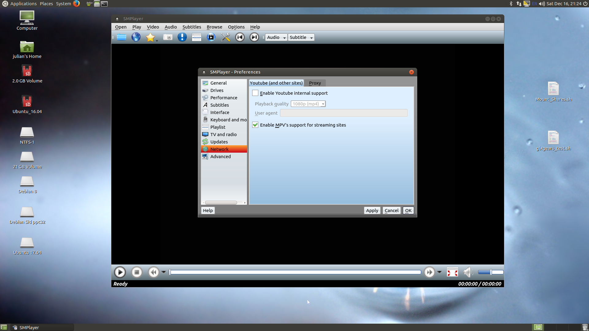

Try Youtube browser for SMPlayer and Smplayer.
sudo apt-get install smplayer smtube mpv

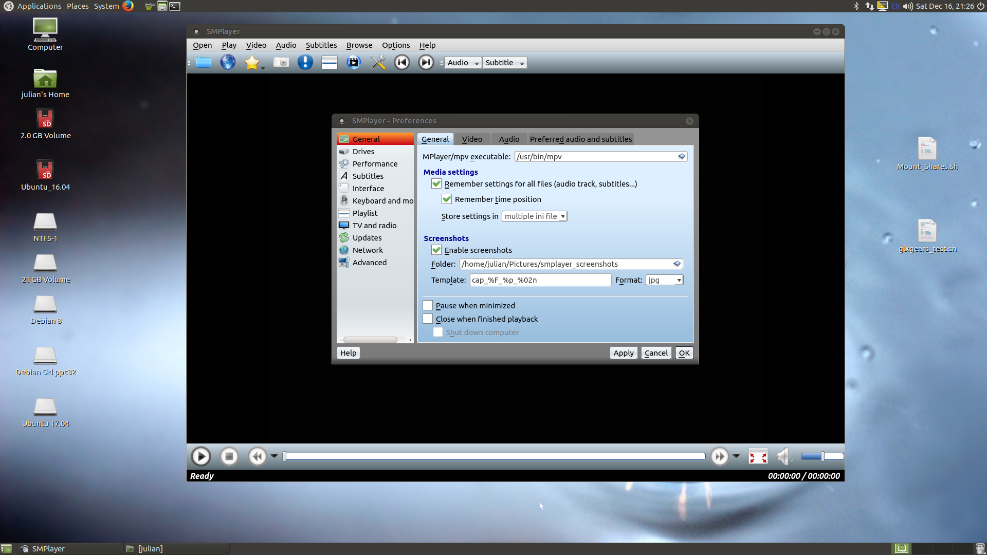

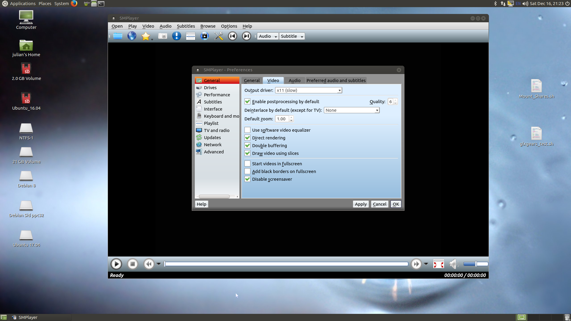

For Smplayer you need to set the correct video driver in the Options:General:Video
In your case for a Radeon SI card = X11 (slow).
Also make sure that the Mplayer/mpv executable is /usr/bin/mpv
You may also have to install mpv (cant remember is installing smplayer did this automatically)

Spectre660 wrote:Try Youtube browser for SMPlayer and Smplayer.
I thought I used to use something called SMPlayer on the Amiga, but it certainly wasn't anything as fancy and useful-looking as that. However, it doesn't work, only "unexpectedly" crashing for my first tries at YouTube browser, but now just nothing. On the other hand, after setting to X11, it will jump through an MP4 with less than a second of motion in greatly separated scenes.

Posts: 1538
Re: Youtube, etc.
Smplayer Settings
Posts: 1538
Re: Youtube, etc.
Smplayer settings 2
