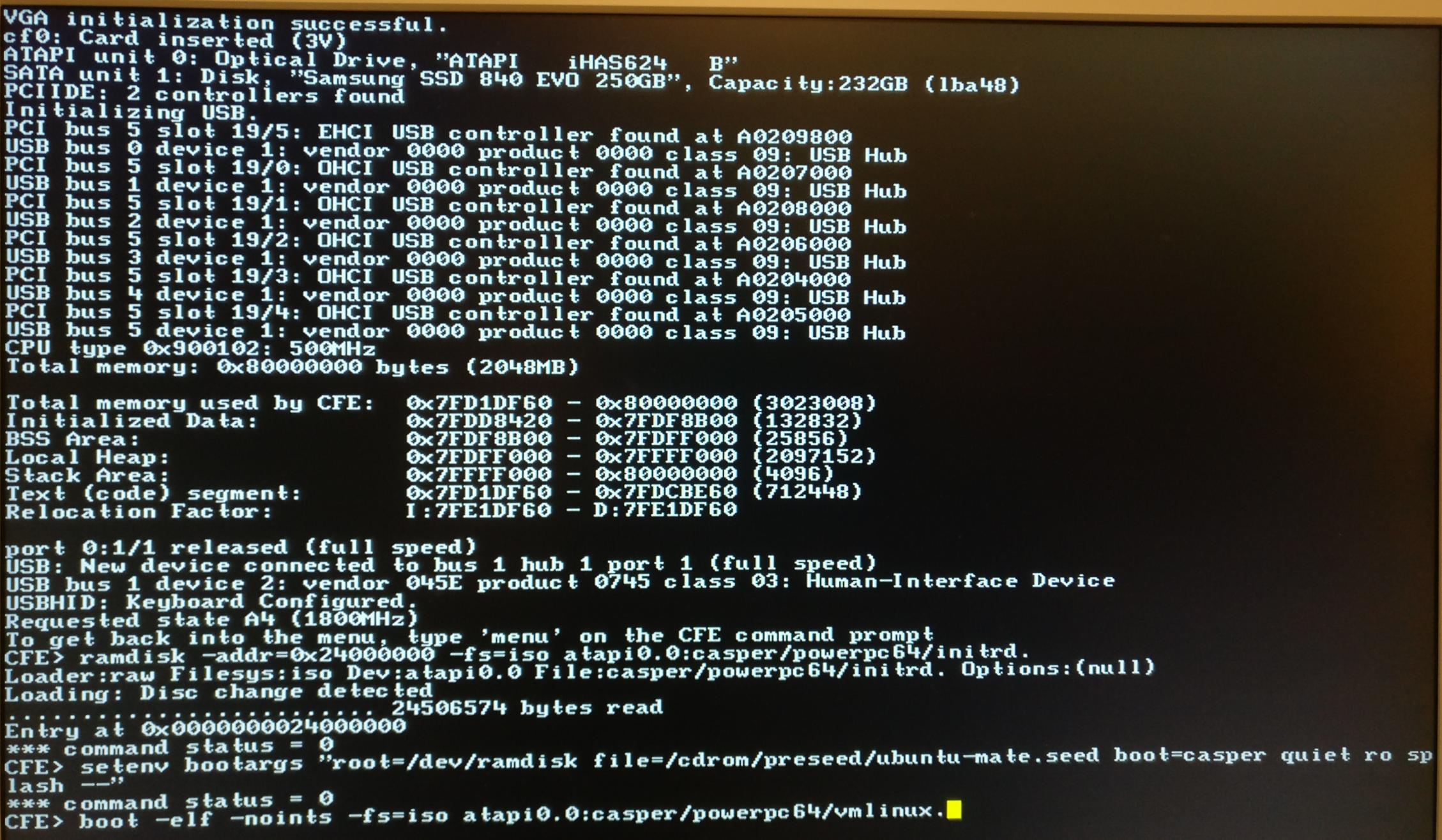

overview - ramdisk - setenv

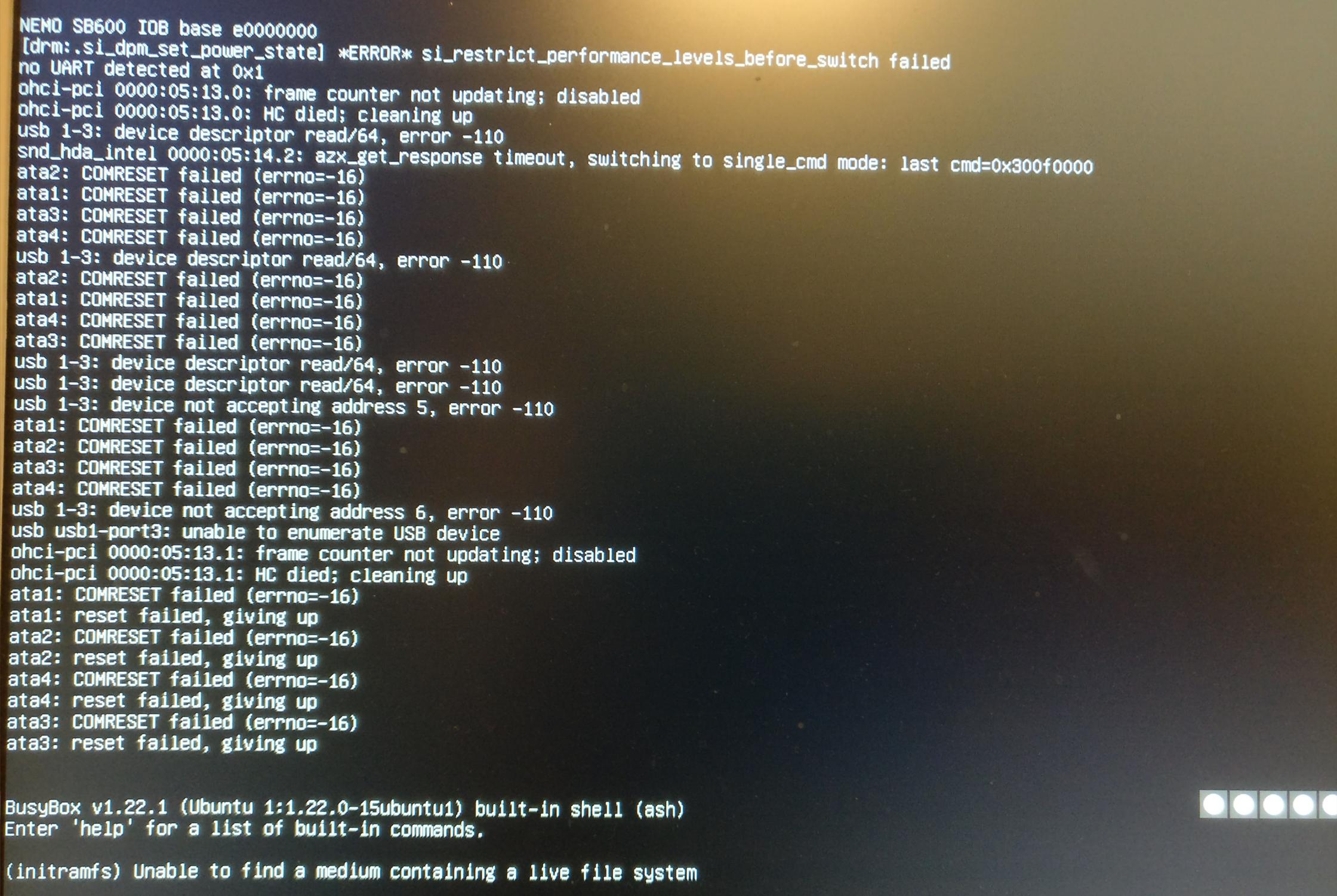

boot
boot
after the penguins and the ubunto logo...
what also is interesting is that my dvd drive is names atapi0.0 and not 0.1
it *is* connected to SATA0 and my ssd is connected to SATA2. just like described in the x1000 setup guide.

I think the image isn’t the problem. The Linux kernel can’t initialize your graphics card.
Unfortunately I can’t say why it doesn’t initialize your graphics card but we have to figure out why.
