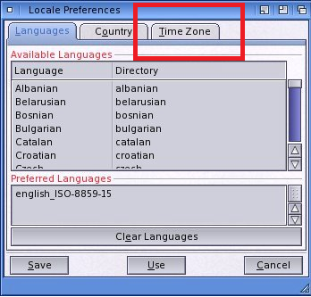

kilaueabart wrote: Aside from Locale Preferences, I can't find any TimeZone prefs.
Are you sure?
locale preferences
locale preferences
