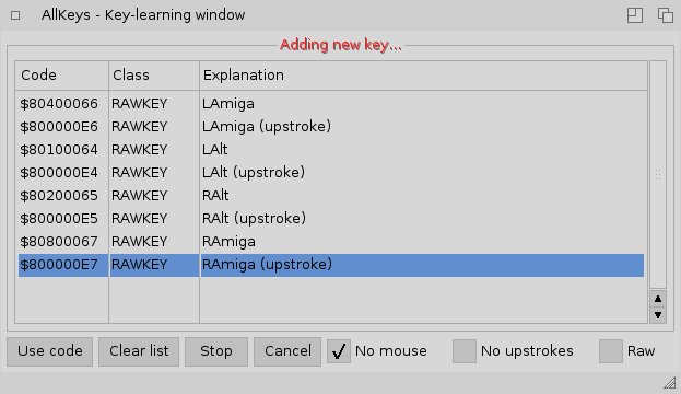

I believe you can examine the actual keycodes emitted from each key with the help of Deniil's Allkeys program.

Yes you're right. This "Ducky Shine 6" Keyboard must be somehow special... Because i configured now the Allkeys Utility and it still doesn't work
Another interesting thing is, above the numeric keypad (so in the upper right corner of the keyboard) there are 4 "Multimedia" Keys, when i hit them Allkeys reports nothing. But this information only as a side note. Any idea about my main problem with the ALT and AMIGA key swapping?
