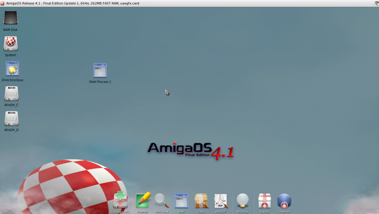

@tony
To show what we mean about "wrong iconify position of shell by default", there is more info:
1) i install FE , upply update1 (but that will be with pure FE the same of course)
2). amiga+e , newcli and shell spawns.
3). press iconify on that shell window, and, instead of placing in the right wb-slot rigth after other icons, iconified icon of shell placed somewhere the middle of the screen. See screenshot:
With fix i quote in previous mail, it placed correctly. Probably, will be good if it will reacts by default like after fix.

OK, I can't get it to happen on the WB that you get after booting the X5000 Install disk, it works fine there.
I'll try a new FE + Update on the Sam 460. I notice that you specify RAmiga/E + NewCLI - does it still happen if you double-click the Shell icon in System/ ?
On my "clean" systems here, I have changed the Shell icon to specify the size and position to the RHS of screen. That icon is of course snapshot within the System/ directory and I can't see any problem.
I'll try a fresh install...
OK, it happens on a clean install, before I modify the Shell icon or snapshot it. It is a simple change to fix the problem and I thought I had done it some years ago, but no.
Now fixed.
