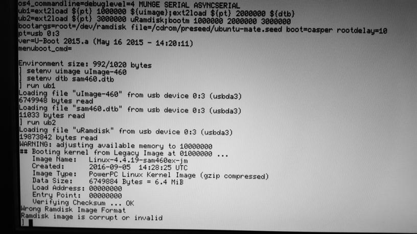

Tried that version and I get:
Wrong Ramdisk Image Format
Ramdisk image is corrupt or invalid
I used a windows machine to "copy" (dd) .img (IIRC rufus.exe program) to a 2GB USB drive.

Posts: 1538
Re: Ubuntu Mate 16.04.1 Live USB
It should not matter what you use to write the image.
Something went wrong for you as version 3 has kernel 4.4.30 not 4.4.15.
I just downloaded and tested version 3 to verify that the uploaded image is ok .
wrote the image with USB Image tool under Windows.http://www.alexpage.de/usb-image-tool/
Worked perfectly.

Recheck my uboot settings and I had a typo, corrected and booting fine now from USB drive with img_V3 :-)
ubuntu-mate@ubuntu-mate:~$ uname -a
Linux ubuntu-mate 4.4.30-sam460ex-jm #5 PREEMPT Sat Nov 5 11:17:31 AST 2016 ppc ppc ppc GNU/Linux
Nice job man!!!!!
