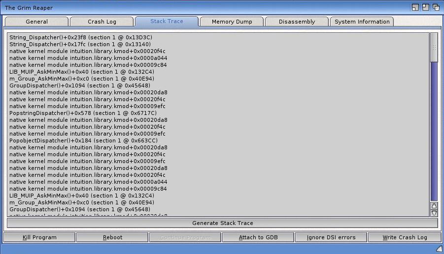

I got it working, but tonight i'm having some weird issues.
First, when i start YAM, and check for mail, it gathers around 280-300 mails each time before it either crashes with a GR, or i press get mail again for another 280-300 mails.
BUT.. Last night i got the "Updates available" window, so i clicked "Download", to install the new MUI mcc-classes. (BUT this reminded me about the MUI update, so i installed that first, then rebooted) but the mail download window just kept looping in connect mode, so i went to githbub webpage instead, using the newest Odyssey.
I middle clicked on the different classes to open each in a new tab, but after opening 3 or so tabs, i got a GR.
I rebooted, and tried again, same result. Next time, i did it the slow way, suspecting the site was heavy or with some code Odyssey didn't like, and i finally got the mcc classes. I installed them, and rebooted. 5 minutes after, I was uploading about 50MB in about 20-25 PDF files to GoogleDrive, when it crashed and i had to reset with the reset button on the X1000. When it rebooted, it crashed at iPrefs in startup-sequence.
I tried to see what files had changed around that time, but i ended up booting from hd1: which is the second partition, that i use as a fallback / emergency solution when my boot partition fails. Lucky i have a habit of often copying the system partition to Storage:OS Disk Backups/ which i had done before installing MUI.
I ended up just copying the backup of my system partition back and reinstalled MUI and the classes, not tried YAM yet.
I am starting to suspect my hard drive or the flimsy sata cable i replaced tonight. Time will show. :-P
I attached some pics of the GR who mentions "Mccprefsdispatcher", "LIB_MUIP_AskMinMax()....", and "GroupDispatcher...".

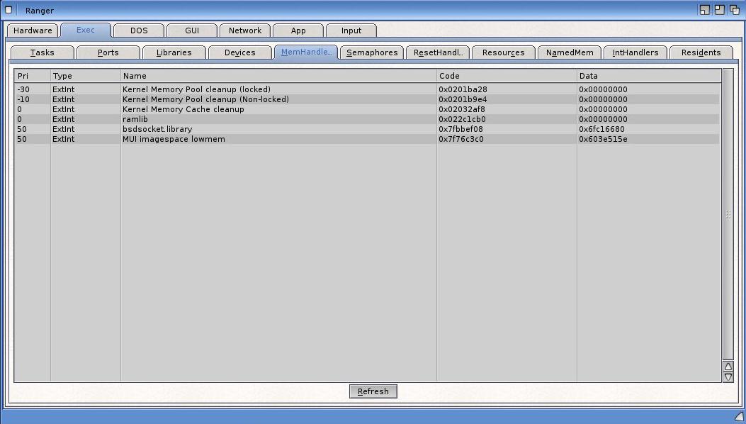

MUI imagespace lowmem? is this a handler, or a warning/status?
