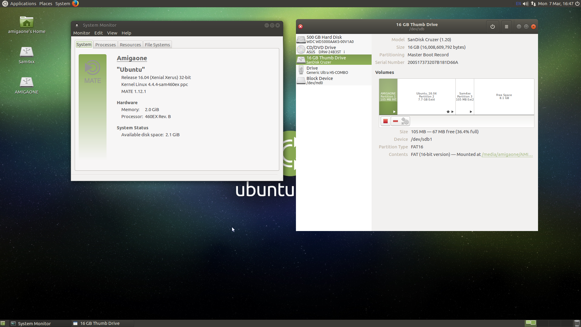

The next step.
Ubuntu-Mate 16.04 running from a USB thumb drive.
Just copy the .img file to a USB thumb drive and boot into a complete Linux Graphical environment.
.img file to be uploaded soon .
