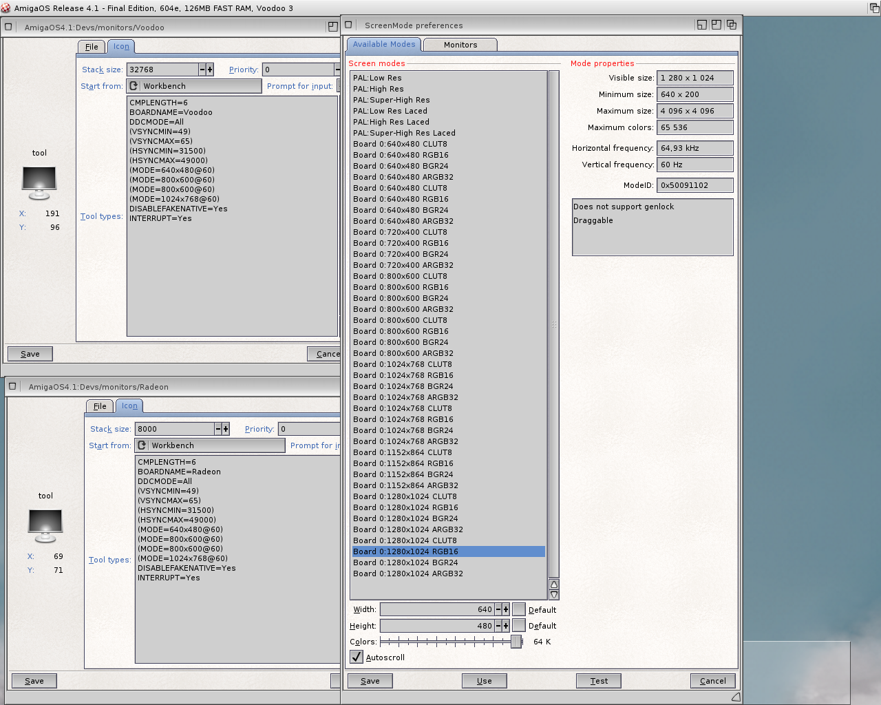

I'm really unsure how to set this up, or if it's possible at all but it doesn't seems to matter how many monitor files i put into devs:monitors (or removes). I only have a board 0: in the Available Modes tab in screenmodes. I think that additional graphic boards are supposed to be named Board 1: Board 2: etc.
Attached to this message is a screenshot from my screenmode preferences showing lots of screenmodes for Board 0:

I would think they would show up as Board1, Board2 etc. but as I said, I don't use a classic Amiga.smf wrote:@xenic
I think you see all those screenmodes because you have 'DDCMODE=all' set in your monitor tooltypes. Those are probably all the screenmodes your monitor is capable of displaying. I suggest you read the documentation at http://wiki.amigaos.net/wiki/Workbench/Prefs/ScreenMode.Attached to this message is a screenshot from my screenmode preferences showing lots of screenmodes for Board 0:

What bothers me is, if you look at the screenshot from screenmode prefs a few posts earlier is that both cards are identified as Board:0, they should be identified as board:0 and :1, shouldn't they? I have double entries of all screenmodes with both cards installed but they all use the voodoo. if the radeon is removed i only get one entry of every screenmode.

I think it is supposed to behave that way, board:0 and board:1, etc...but I just don't think it's supported in the kernel to support two PCI graphic cards like that, unfortunately.smf wrote:commenting out the x86emu.resource doesn't help at all since it stops the Radeon from being initialized, just like you said![]()
Yes the radeon card works just fine in OS4 if i don't have the Voodoo3 card installed, i actually have two different radeon cards to test with and they both works just fine as long as i don't have the voodoo3 installed. (there's just garbage on the Radeon monitor and the voodoo3 displays just fine.)
