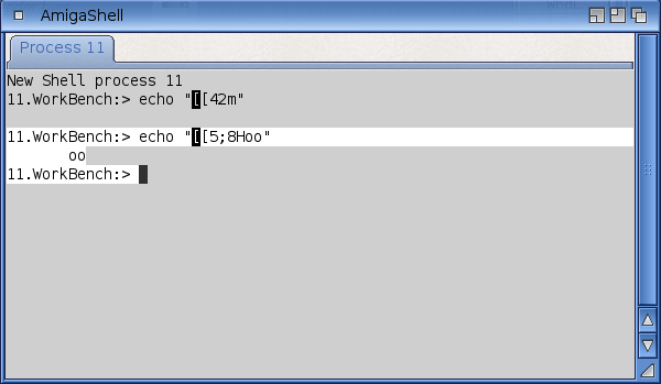

I am going to release an update to PDFToolkit, but found that the program looks broken in 4.1FE consoles.
I present the problem with a simple echo command in the shell.
Here is a picture from the UAE 3.1 installation (it is the same on 4.1 update 6, but I can't boot it now):
And here is the OS4.1FE result with the a same control codes:
You can see the the background color is rewritten from the first character in the row instead of just for the printed characters.
If it is an intended change, I have to find a workaround.
Can't found anything about the change.
Please let me know the reason of the new behaviour.
Thanks!

That is not an intended change and could be a bug.
I'll take a look at it.
(time passes)
I confirm that it is a bug, submitted as #9193.
cheers
tony

OK, I've found the fault and fixed it, but I haven't released it to the betatesters yet.
The fixed version will not be released to the public for some time, so I suggest that you invoke a work-around anyway.
The problem is caused by the order of the operations:
1. Change background colour;
2. Position cursor to new place past the end of the line;
3. Fill with new spaces from the end of the line to where the new text is going;
4. Write the new text ("oo"" in your example).
Step 3 fills the line with spaces, but the new "fill" spaces are written in the new background colour. If you are over-writing existing characters, the problem does not occur, it only occurs when filling past the end of a line.
One work-around that I recommend is to change the order of operations:
if (new place is past the end of the line)
move cursor to end of line;
draw spaces until you get to the new place;
else
move cursor to new place;
change background and/or foreground colours;
write the new text.
That should work OK.
