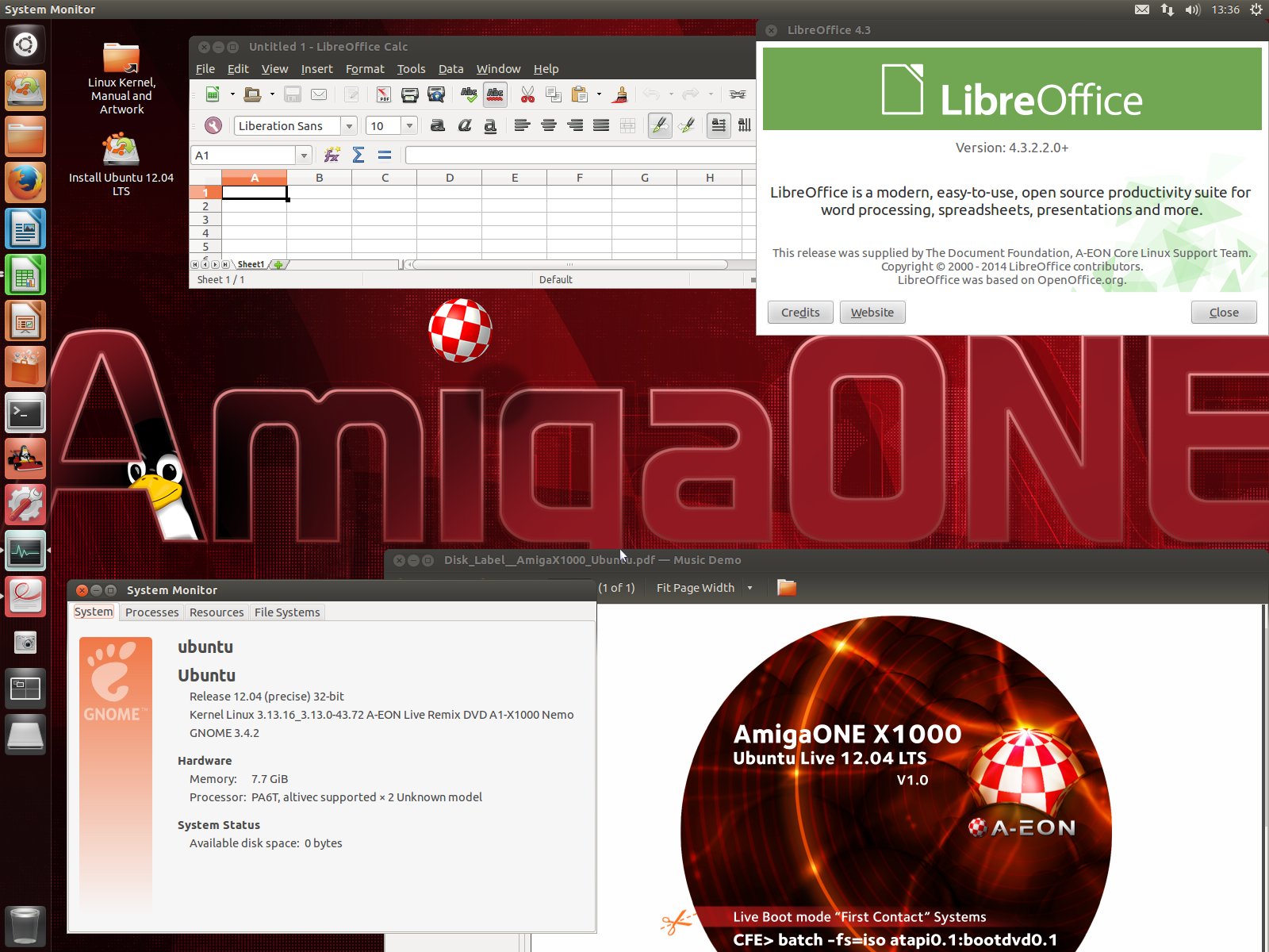

First, the new DVD will be released soon in AMIStore. Screenshot of the new A-EON Live Remix DVD:amigasociety wrote: Would be nice to also make a new DVD or is that not needed as the kernel will be on CF Card and not the DVD anyway?
Second, if you use the live mode then you don't need an installed kernel on CF card. But if you want to use a new kernel for the live mode or for an installed Live Remix distribution, then I would recommend to install the kernel on the CF card.
