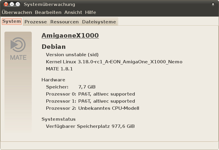

Re: Kernel 3.18
The RC1 on Debian Sid:
Re: Kernel 3.18
Post by zzd10h »
Image :mrgreen:
Re: Kernel 3.18
zzd10h wrote:Image :mrgreen:
Thank you for testing!
Re: Kernel 3.18

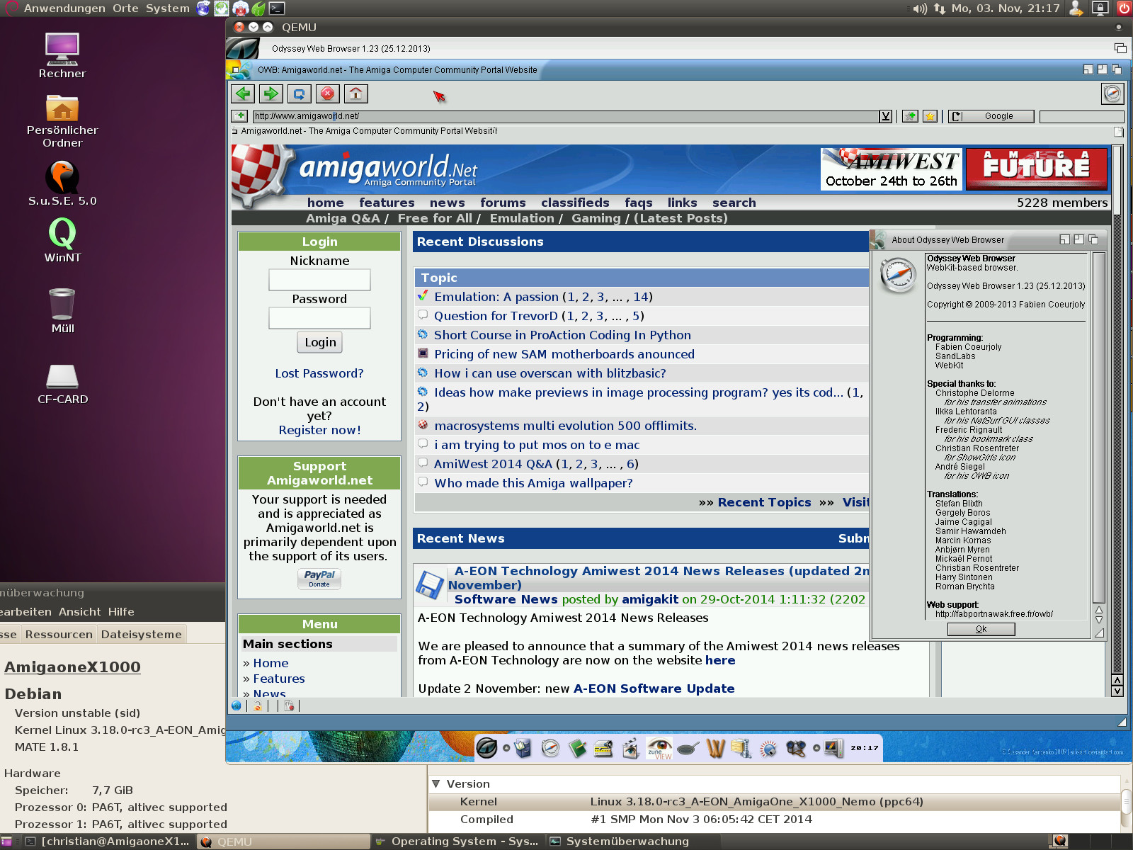

I have compiled the RC2 for testing: vmlinux-3.18.0-rc2-KVM-PR-FTRACE-AmigaOneX1000.tar.bz2. :-)
Re: Kernel 3.18
I have released the RC3 of kernel 3.18.
Download: vmlinux-3.18.0-rc3-KVM-PR-OVERLAYFS-AmigaOneX1000.tar.bz2
Re: Kernel 3.18
Post by zzd10h »
And as usual, it works !
Re: Kernel 3.18
zzd10h wrote:And as usual, it works !

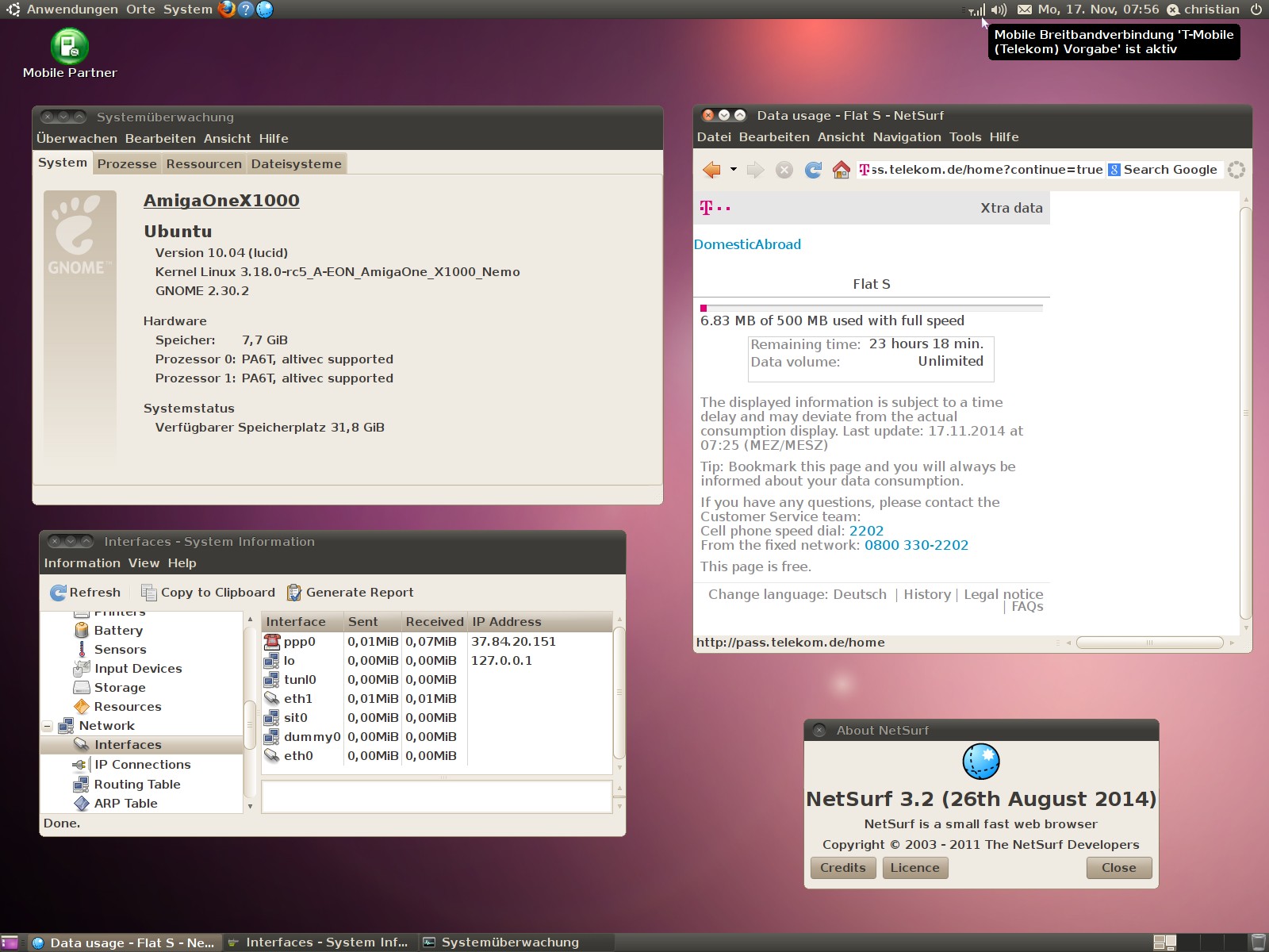

Re: Kernel 3.18
I have released the RC4 of kernel 3.18.
- Support for mobile networks with USB UMTS 3G sticks
- KVM_BOOK3S_64_PR
Support running guest kernels in virtual machines on processors
without using hypervisor mode in the host, by running the
guest in user mode (problem state) and emulating all
privileged instructions and registers.
This is not as fast as using hypervisor mode, but works on
machines where hypervisor mode is not available or not usable,
and can emulate processors that are different from the host
processor, including emulating 32-bit processors on a 64-bit
host.
- Mac-on-Linux support
- Network support for AROS hosted
- Support for 4 serial ports
- Bluetooth USB dongle support
- Kernel tracing with ftrace
- Linux kernel icon for OS4.1 by Tommysammy
Download: vmlinux-3.18.0-rc4-KVM-PR-OVERLAYFS-AmigaOneX1000.tar.bz2
Please test the RC4.
