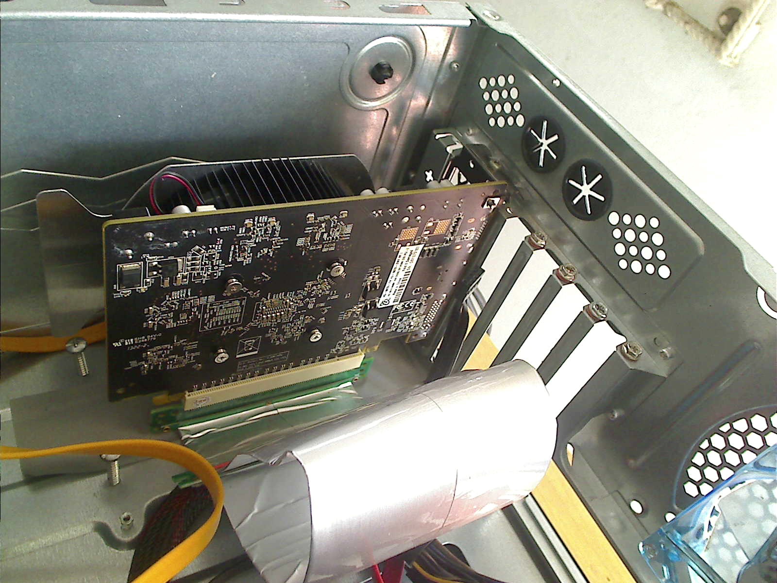

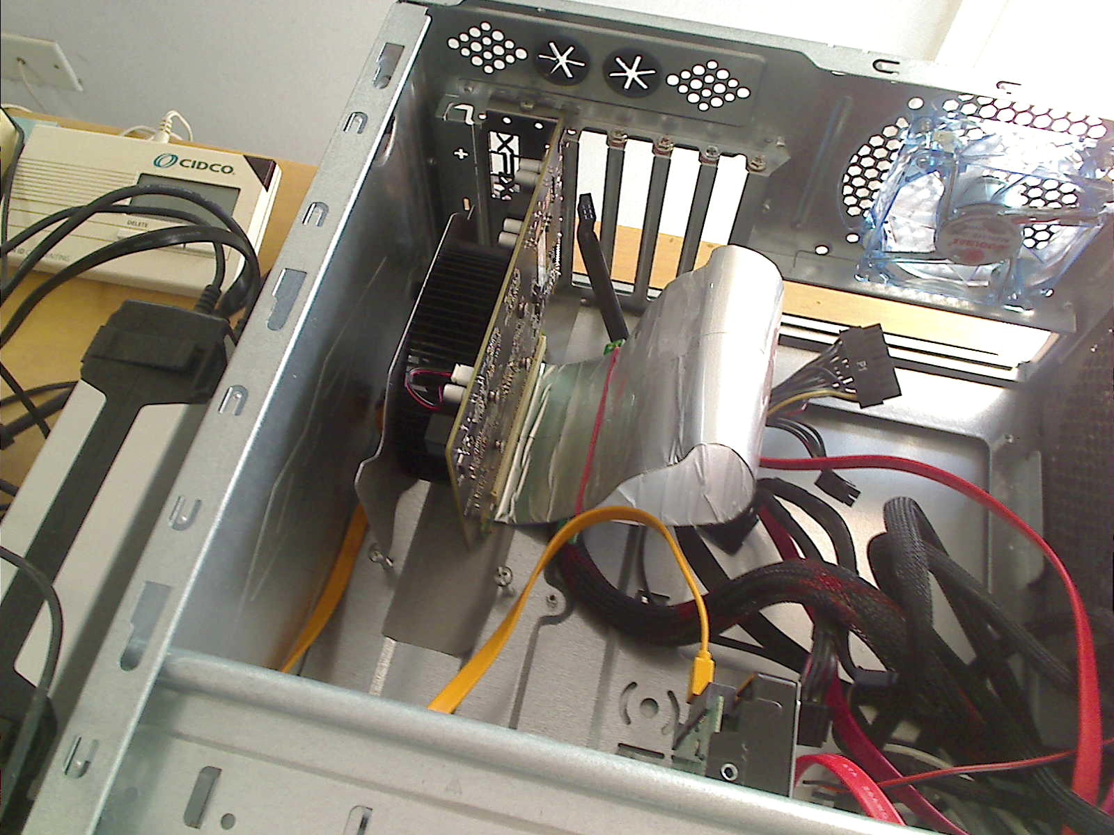

Posts: 1538
Re: VTX Radeon HD 6670 1GB GDDR3 not working
Dual slot RadeonHD 6670 with pcie riser waiting for a Sam460 motherboard.
You need a long enough cable on the riser to go to a position 4 slots down and over the PCI and PCIEX1 cards.
This cable is 30cm long.
http://www.ameri-rack.com/ARC1-PEVX16A2-Cx_m.html
http://www.newegg.com/Product/Product.a ... 5751ZF6655

@Spectre660
What you are doing is indeed what I was planning to do.
I am using the dual slot video card using the internal SD card, so dropping the use of the hard disk.
I've attached the cdrom to the usb port using this:
http://www.chinatraderonline.com/USB-Pr ... 110500601/
Posts: 1538
Just to update. This solution is indeed working.
The 30cm cable on the riser loops nicely over the PCI sata card and Pciex1 sound card.
