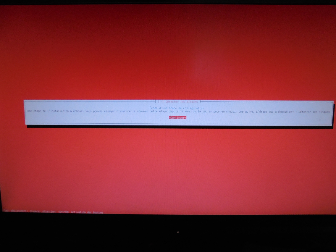

I have problem installing Lubuntu 14.10. I'm stuck at disk detection during the install process.
Following Xeno74 advices, I
1) added 3.17 kernel to my CF card (tested and booted OK under 12.04)
2) added the right initrd.gz to my CF card
downloaded from
http://ports.ubuntu.com/ubuntu-ports/di ... /initrd.gz
3) Booted with following CFE commands
CFE> ramdisk -z -addr=0x24000000 -fatfs cf0:initrd.gz
CFE> setenv bootargs "root=/dev/ramdisk"
CFE> boot -elf -noints -fatfs cf0:vmlinux-3.17
But install process fails at disk detection (the ethernet detection step is OK)
Failing step (in french)
When I exit the install process, I can see my partitions with cat /proc/diskstats
I have only 1 disk on my x1000 with AOS and A-Eon Lubuntu 12.04 (/dev/sda4) partitions.
Thank you for your help
Guillaume

Re: Problem installing Lubuntu 14.10
Thanks a lot for your bug report. First, could you try to install Lubuntu 14.10 with the Ubuntu longterm kernel 3.13.14?
Download: kernel-3.13.14-1-x1000-ubuntu-ppc64.tar.bz2
If this doesn't work, you could try to install Lubuntu 14.04.
Initrd for Lubuntu 14.04: initrd.gz
If this works then you could update it to 14.10. And we have to create a bug report for 14.10 on launchpad.net.
Post by zzd10h »
It's me who thanks you ;)
1) same problem with 3.13 kernel
2) same problem with the 14.04 initrd with 3.17 kernel and with 3.13.14 kernel
Maybe it's related to my volume partition scheme ?
I have only 1 HD with all my OS4 and Linux partitions. Of course, it worked with 12.04 AEon Linux DVD.
