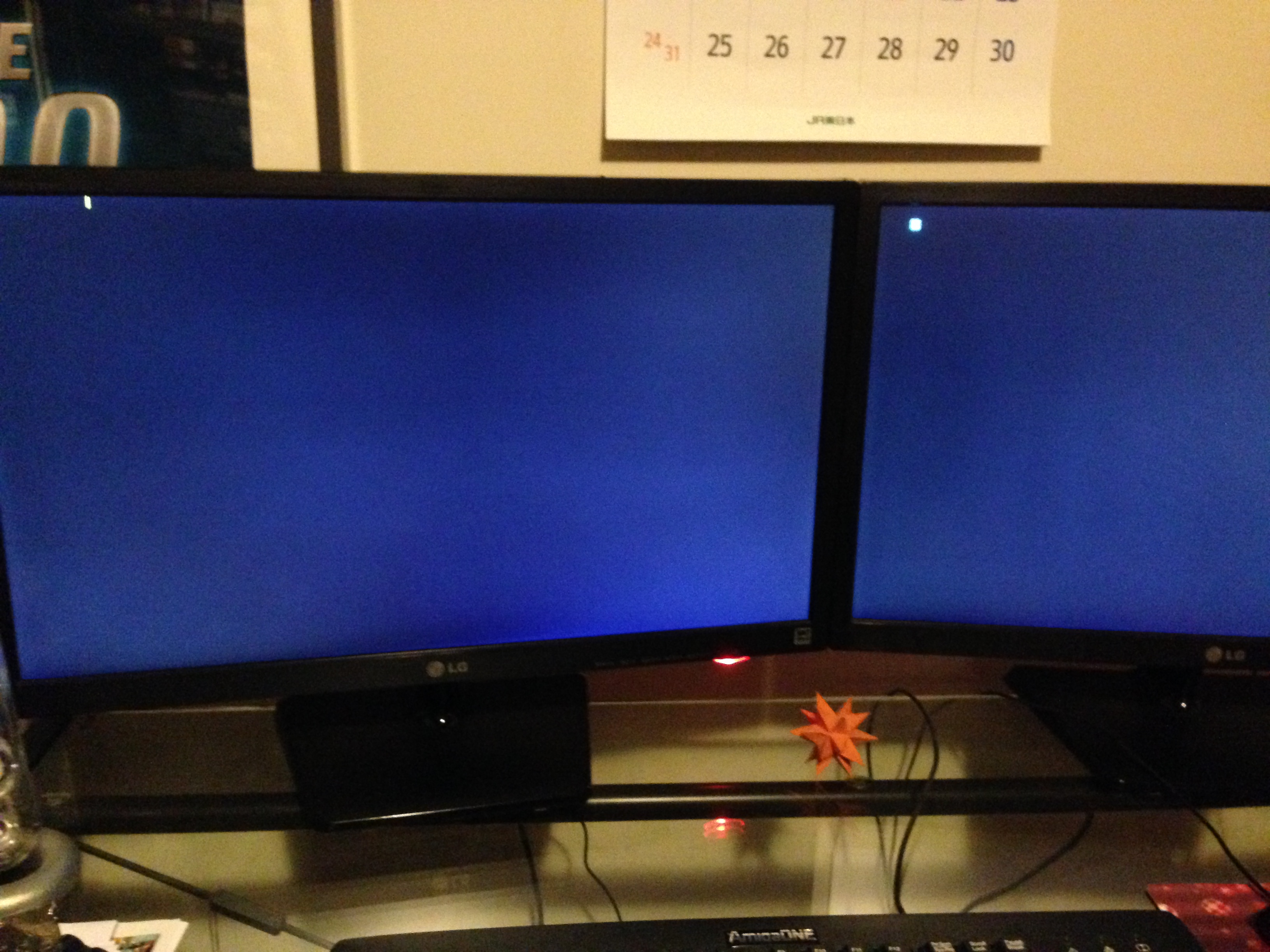

I tried this evening creating the additional PCIGraphics2 monitor driver in DEVS:Monitors under AmigaOS4.1.6 (i did modify the length field because it is now 12 instead of 11 for PCIGraphics), but still the same result, it freezes when the progress bar completes on the x1000 boot screen with the three cards installed.
two pci-e card displays and 1 pci card display - x1000 boot screen freezes when progress bar reaches end. 9250 pci card never displays anything during boot up.
Interestingly I also got a 9250 PCI card from Amigakit for my A4000T today and decided to try it out as well in place of my regular 9250 pci in the x1000 (with the two other pci-e cards installed). On boot up I don't get the X1000 boot screen AT ALL - I get a screen with a yellow cursor (normal) and a screen with a blue cursor (which I have never seen before). Only differences between the two 9250 pci cards is the normal x1000 one is half height pci, the amigakit is full size, and that the amigakit supplied one support both voltage pci type connectors. Strange.
Yellow and Blue cursors in the pci-e card displays with 9250 pci from amigakit installed in the x1000 on boot up.

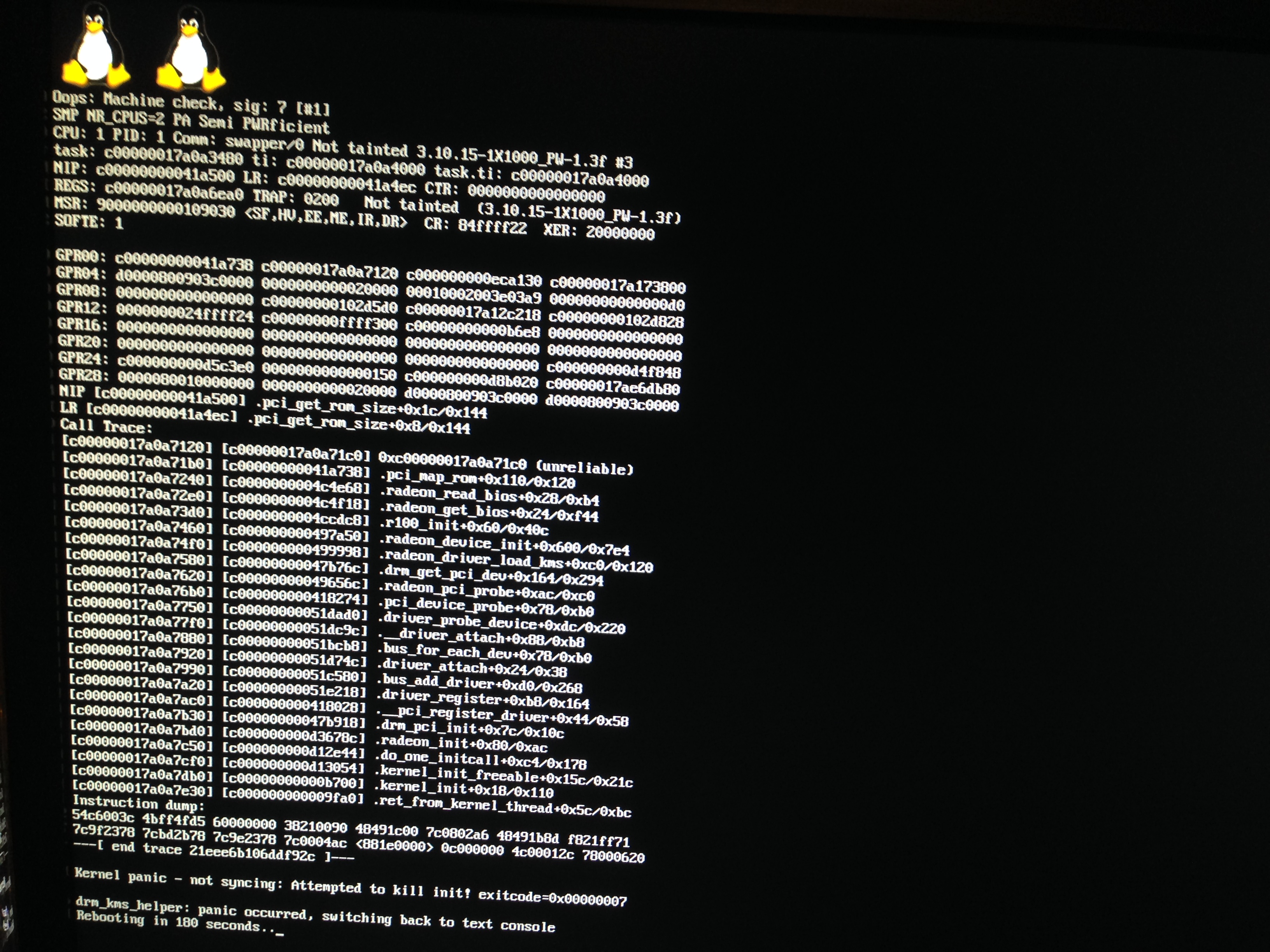

As a side note, I tried to boot ubuntu remix linux on the x1000 with only the two pci-e cards installed and got a kernel panic on boot...a topic for the linux forum i know, but I thought it worth mentioning rather than creating another thread about it.
Linux kernel panic booting ubuntu remix with two pci-e cards installed in x1000

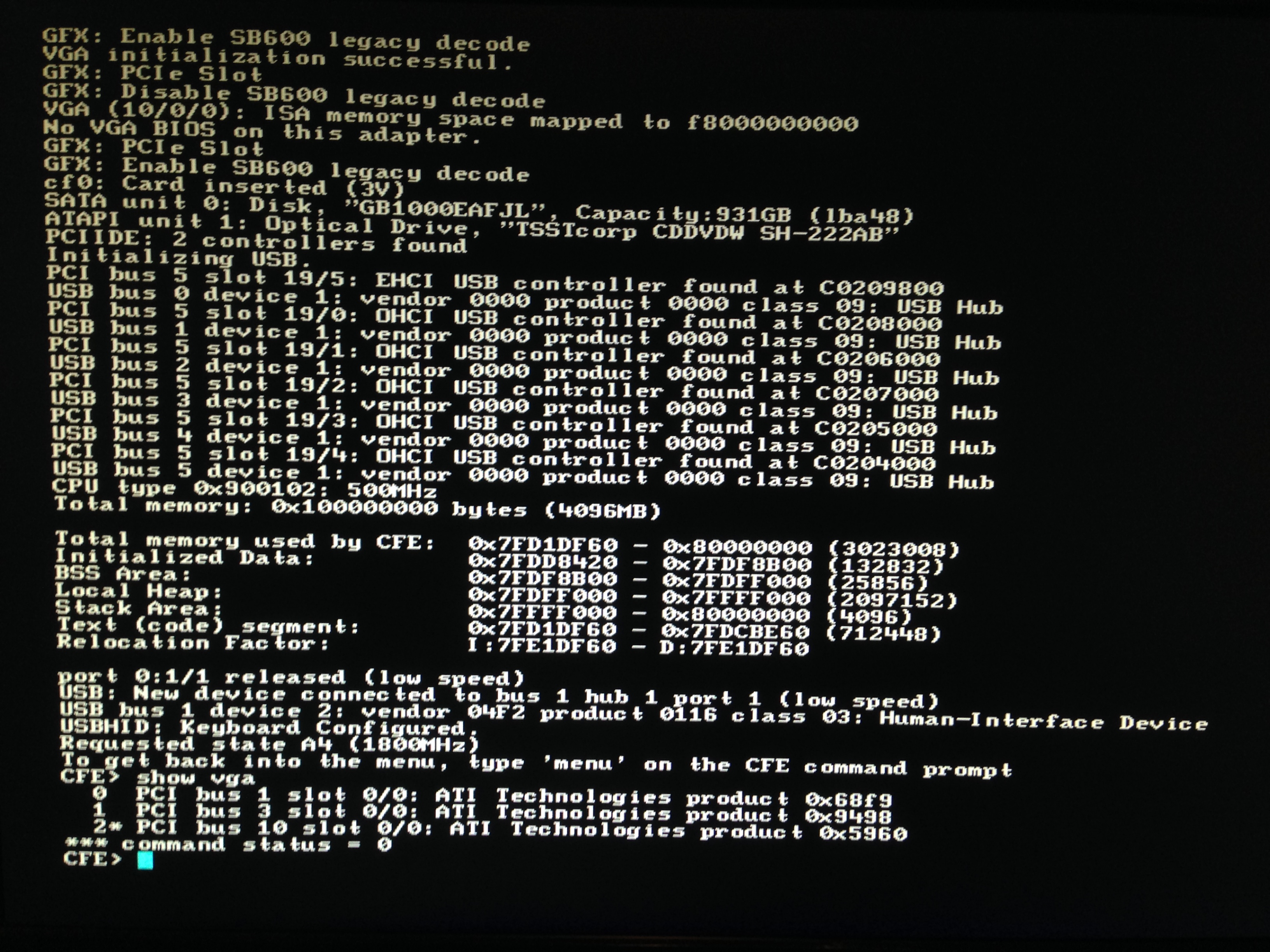

output of show vga command in cfe showing the two pci-e cards and one 9250 pci
Higher up it says "VGA (10/0/0): ISA memory space mapped to f80000000000" and then "No vga bios on this adapter"....I assume it is the 9250. It works fine when installed with one pci-e card, but not with 2 pci-e cards as well as itself...what is happening?

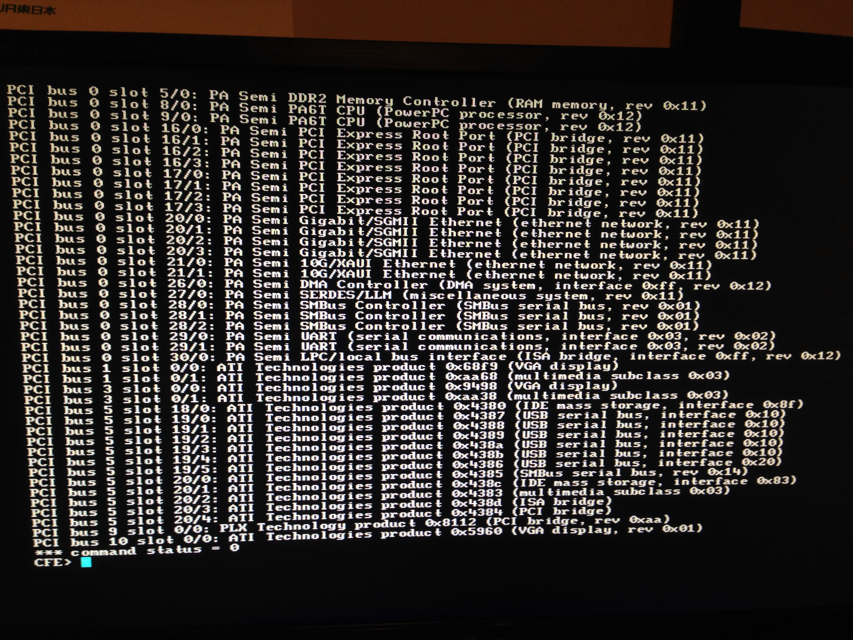

Also did a show pci in CFE in case this helps at all, showing the devices connected. Note that at this point I had the 9250 PCI connected to a PCI-e to PCI adapter, as I hadn't tried that configuration as yet. It didn't work either, stops at the same point.
output of show pci command in cfe showing the three gfx cards.

Epsilon wrote:I booted into CFE and did a show vga command to show the three cards are recognised as present by CFE - not sure if this helps but maybe it does - not sure why one device has a * next to it? is it relevant?
I'm guessing that the * means that the card wasn't initialised properly. That * is next to the card with the error message that you described below.
Epsilon wrote:Higher up it says "VGA (10/0/0): ISA memory space mapped to f80000000000" and then "No vga bios on this adapter"....I assume it is the 9250. It works fine when installed with one pci-e card, but not with 2 pci-e cards as well as itself...what is happening?
That may be what's stopping it from booting. It hasn't managed to get the card's ROM, and therefore can't initialise it. If it was a Radeon HD card, then the driver might be able to still use it (the driver does an ASICInit, although the BIOS not doing initialisation could still cause trouble). However, the card that isn't initialised is the Radeon 9250, and I'm pretty sure that it's driver expects that card to be initialised properly by the BIOS (a.k.a., CFE).
If you have a null modem serial cable and another PC, then we might be able to get more info about how far it gets through booting.
