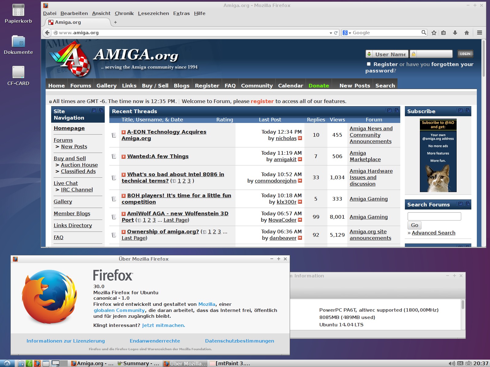

Mozilla released Firefox 29. Ubuntu built Firefox packages in the last week. Unfortunately the compiling of Firefox for PowerPC doesn't work at the moment.
Firefox 29 build status for the A-EON Live Remix distribution/Lubuntu 12.04.4: launchpad.net
Firefox 29 build status for Lubuntu 14.04 LTS: launchpad.net
Package build log for the A-EON Live Remix distribution/Lubuntu 12.04.4: launchpad.net
Package build log for Lubuntu 14.04 LTS: launchpad.net

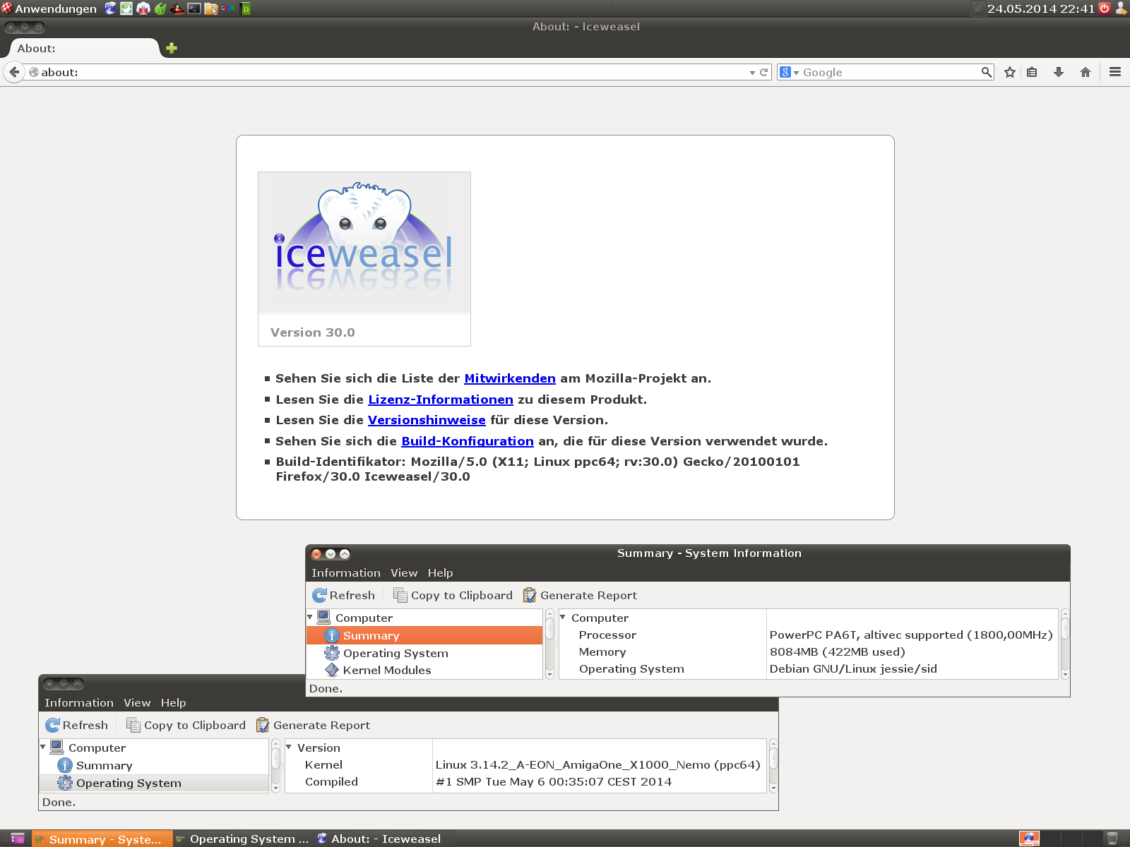

Iceweasel 30 is available :) :) :) :)
apt-get install -t experimental iceweasel

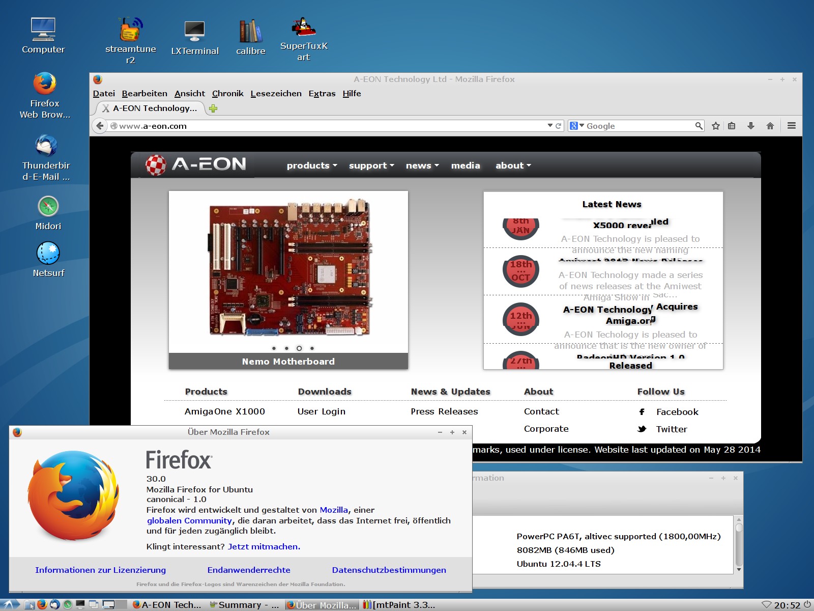

Firefox 30 is available for the A-EON Live Remix Distribution, for Lubuntu 12.04.4, and for Lubuntu 14.04. :)

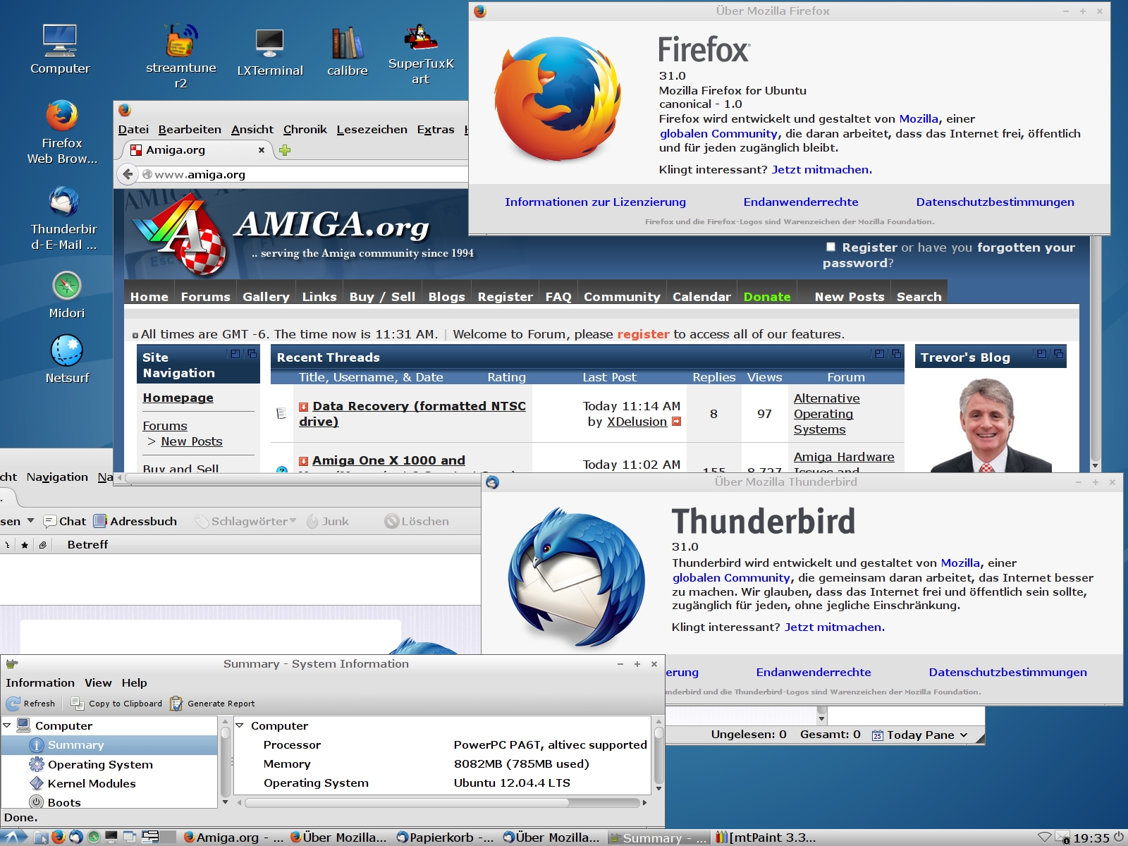

Firefox 31 and Thunderbird 31 are available for our A1-X1000. :-)

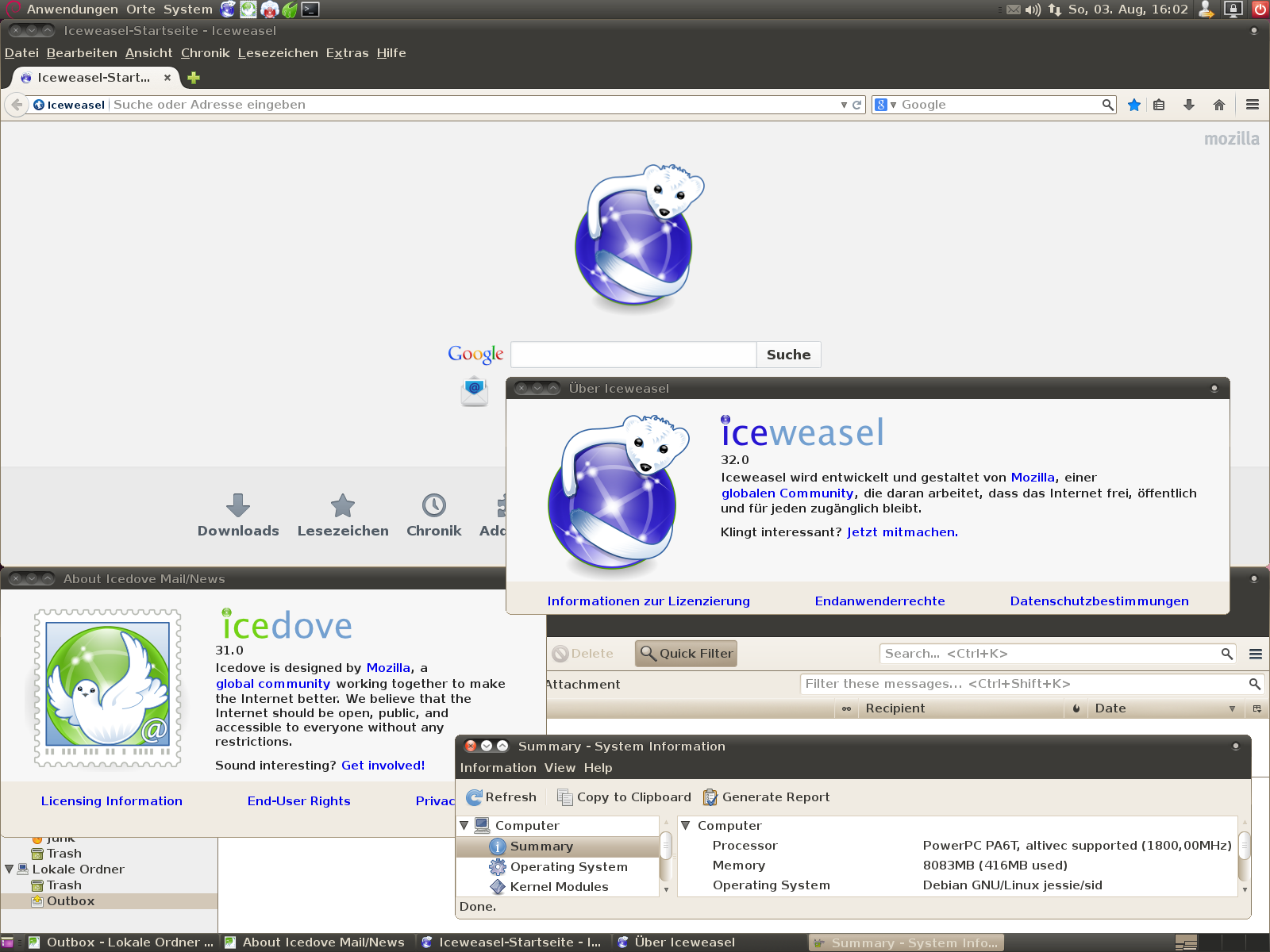

Iceweasel 32.0 and Icedove 31.0 are available. :)
