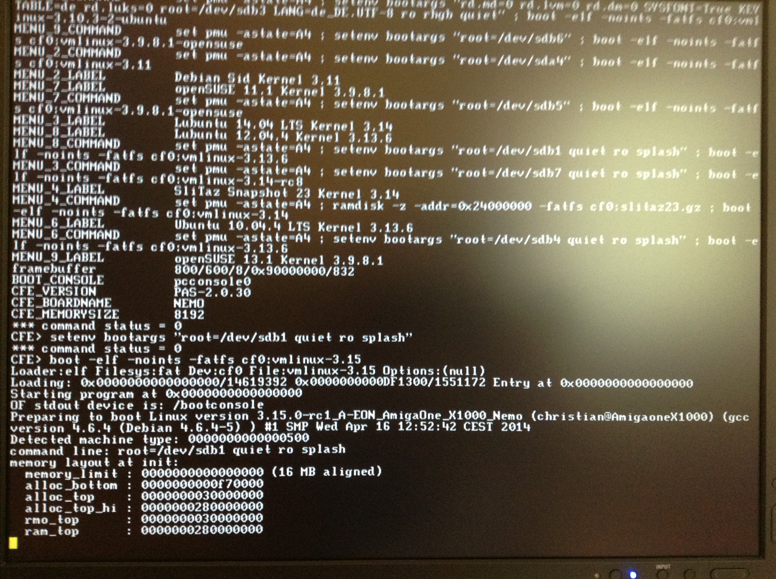

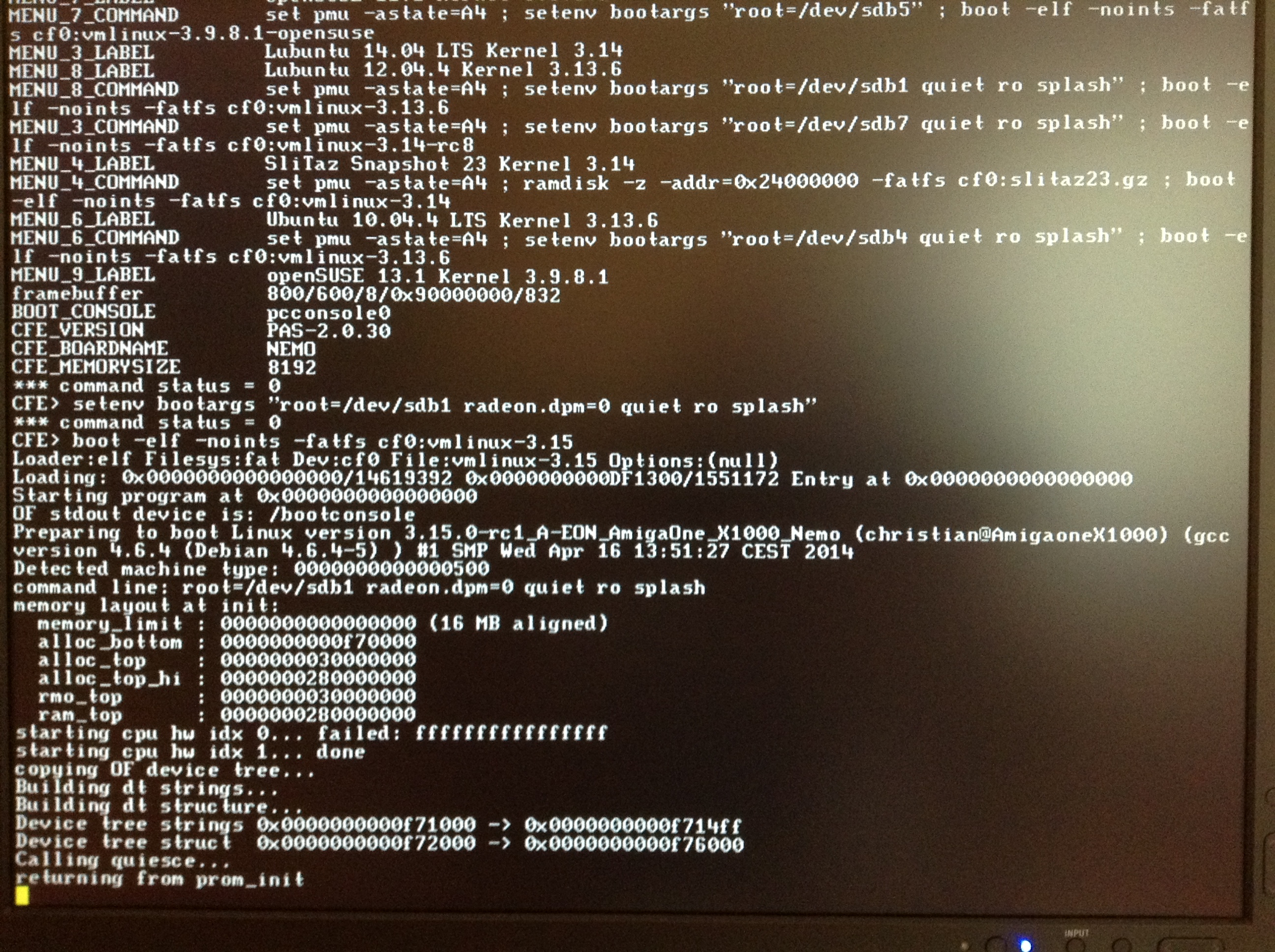

I have some bad news for you. The RC 1 of the kernel 3.15 doesn't boot currently. I don't know why. I have test it with our standard patch with Olof's hack and then I have test it without Olof's hack. But without any success. I have test it with the boot argument radeon.dpm=0. But it doesn't boot. I hope I can figure out why.
First, the config of the RC 1:

The patch with Olof's hack:
nemo_3.15.patch.tar.bz2
(7.5 KiB) Downloaded 639 times

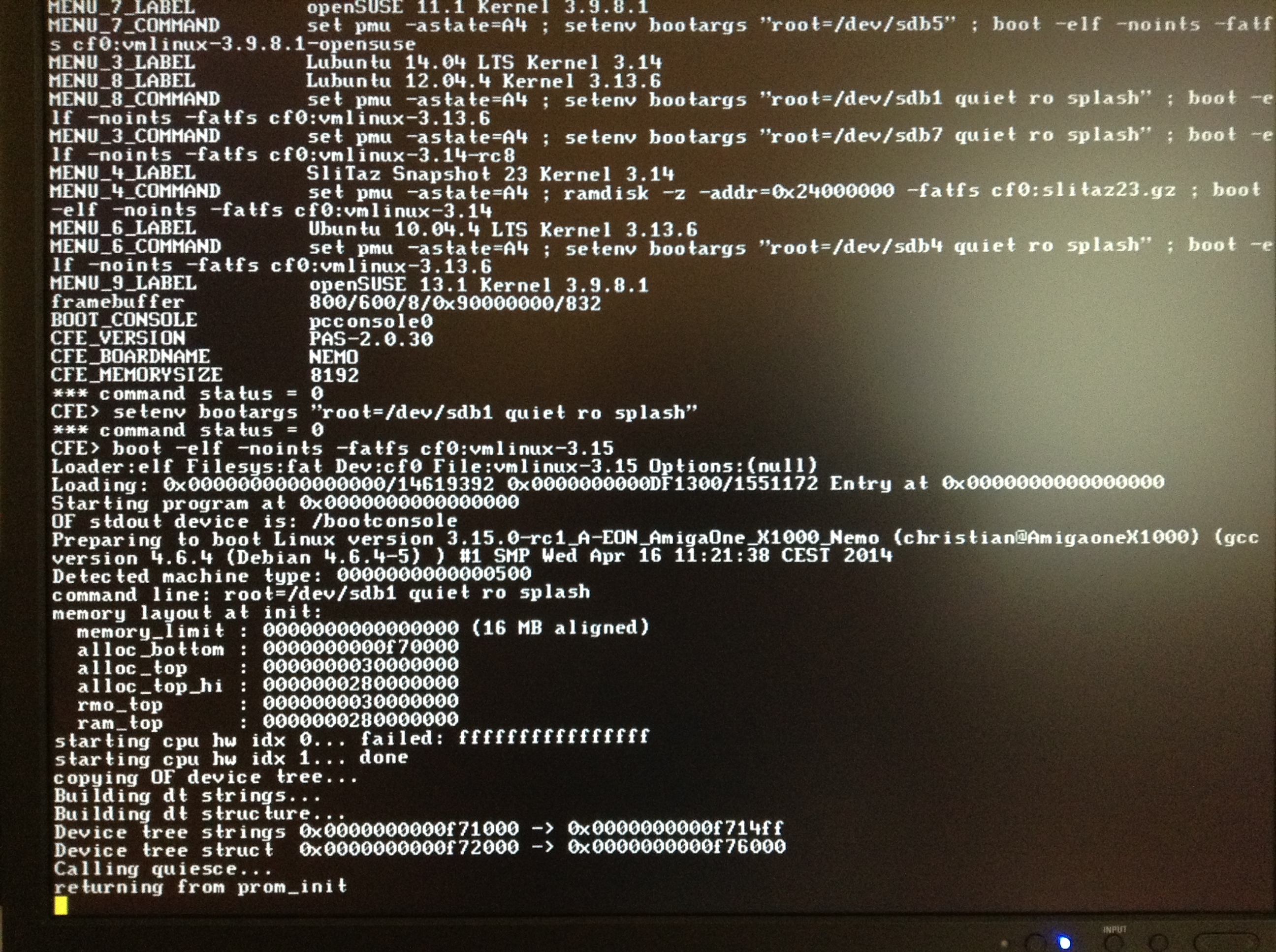

The patch without Olof's hack:
nemo_3.15-alternative.patch.tar.bz2
(7.28 KiB) Downloaded 704 times
Re: Kernel 3.15
RC 1 built with the standard Nemo patch with Olof's hack:
RC 1 built with the standard Nemo patch without Olof's hack:
RC 1 with the boot argument radeon.dpm=0:

Darren tried to catch some serial output to get an idea where it is failing, only it's not generating any. He will try some other configs see if anything helps, but at the moment this looks like there is another early boot problem.

I have found out which patch is responsible for the boot problems. It's patch 9000c17dc0f9c910267d2661225c9d33a227b27e. Link: https://git.kernel.org/cgit/linux/kerne ... 33a227b27e
Experimental protocol:
git checkout -f 01d8885785a60ae8f4c37b0ed75bdc96d0fc6a44; git clean -fdx (from 02/04/14) -> Kernel boots
git checkout -f f1553174a207f68a4ec19d436003097e0a4dc405; git clean -fdx (from 03/04/14) -> Kernel boots
git checkout -f d40326f4b9f9617cdfd30f83a2db57d47e9c5bac; git clean -fdx (from 04/04/14) -> Kernel boots
git checkout -f 930b440cd8256f3861bdb0a59d26efaadac7941a; git clean -fdx (from 05/04/14) -> doesn't boot (rtc error)
git checkout -f 2b3a8fd735f86ebeb2b9d061054003000c36b654; git clean -fdx (from 06/04/14) -> doesn't boot (rtc error)
git checkout -f 26c12d93348f0bda0756aff83f4867d9ae58a5a6; git clean -fdx (from 07/04/14) -> doesn't boot (rtc error)
git checkout -f a6c8aff022d4d06e4b41455ae9b2a5d3d503bf76; git clean -fdx (from 08/04/14) -> Kernel boots
git checkout -f 035328c202d26a824b8632fd3b00635db5aee5a2; git clean -fdx (from 08/04/14) -> Kernel boots
git checkout -f 9000c17dc0f9c910267d2661225c9d33a227b27e; git clean -fdx (from 08/04/14) powerpc/powernv: Fix endian issues with sensor code. One OPAL call and one device tree property needed byte swapping. -> doesn't boot (prom_init)
git checkout -f d3d35d957a9d0733dc51f14b5abc0bff5d3c5f3a; git clean -fdx (from 08/04/14) -> doesn't boot (prom_init)
git checkout -f c4586256f0c440bc2bdb29d2cbb915f0ca785d26; git clean -fdx (from 09/04/14) -> doesn't boot (prom_init)
