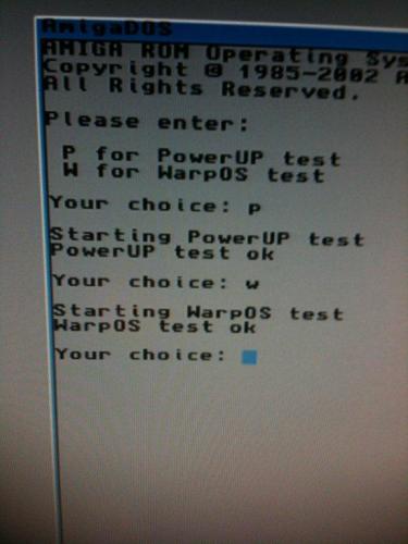

Hi, can you double check the PPC is fully working? Does it work under OS 3.9? You can try running the PPC test floppy which you can download here:
http://powerup.amigaworld.de/index.php?lang=en&page=24
Boot your amiga with it and you can choose to test warpOS and PowerUP. They both should return OK. If they don't there may be a problem with your PPC.
Let us know what the results are. I have attached a photo of a correctly executed PPC test disk.

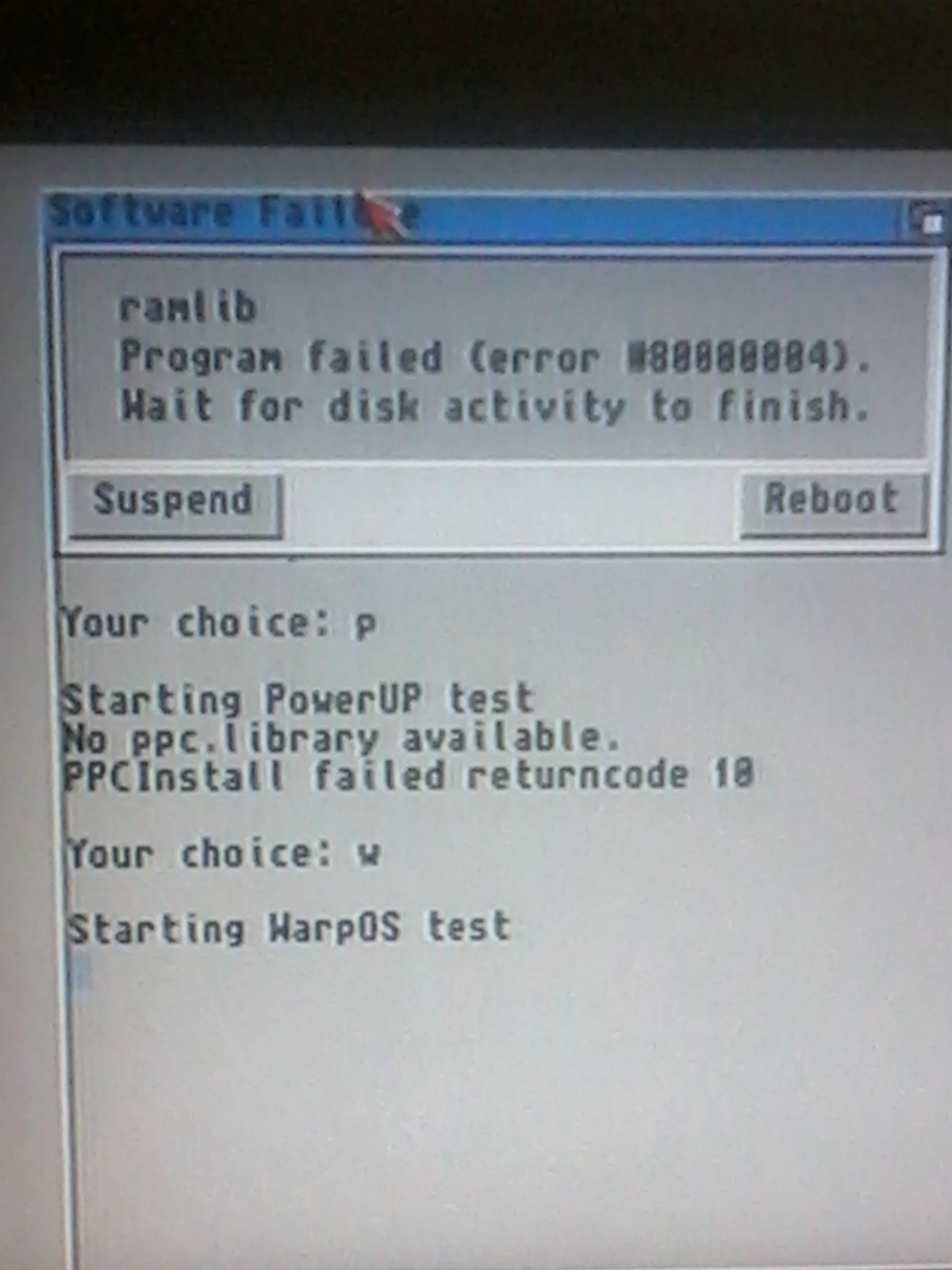

Hi Darren,
I did the test, if I boot from a floppy, after a brief loading the amiga load by hd, but if I disable the HD from startup settings, the amiga load from floppy and run the test once this is result ........
(397.06 KiB) Downloaded 284 times
With the powerup test shows that the ppc.library is not available, with the warp test a window appears and crashes.
I'm very sad ....
Have I a crazy card?
Thanks.

Hi Demidio, unfortunately that means your PPC is not working :( The good news is that it can likely be repaired - there is a person named Stan in Poland that can remove the PPC and re-solder it on. He usually posts under the name stachu on amiga.org and English Amiga Board. He can also upgrade the PPC to a faster one.
Usually what happens over time is that solder joints under the PPC break...
