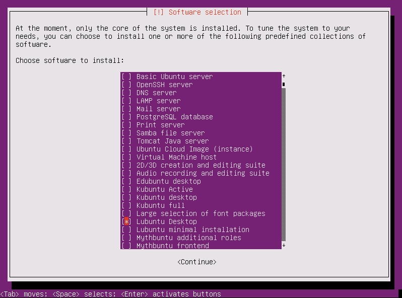

At the software selection screen you will be asked to select which *buntu flavour(s) you would
like to install. You can install as many as you like. To install Lubuntu arrow down to the “Ubuntu with LXDE Desktop” option and press the space bar to mark the
option. Now press return to continue.
Have you selected the Ubuntu flavour?

  25. At the software selection screen you will be asked to select which *buntu flavour(s) you would
    like to install. You can install as many as you like. To install Lubuntu arrow down to the “Lubuntu Desktop” option and press the space bar to mark the
