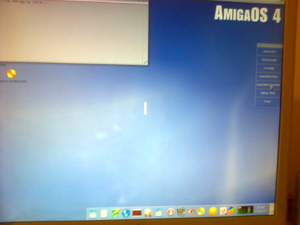

Re: Window size safety check
@tonyw
WA_InnerWidth, 0 / WA_InnerHeight, 0 ==> freeze
WA_Width, 0 / WA_Height, 0 ==> freeze
This is a layoutless Window Class-based window. In all cases no crash output on the Reaper or Sashimi. The window appears as a small grey vertical bar in the middle of the screen (see attached picture) and a complete system freeze follows. This is on a composited Workbench screen. Behaves a little differently with Compositing Effects switched OFF (the vertical bar is not grey but contains window border graphics) but freezes in the same way as with the composited screen.
No window size tags specified ==> freezetonyw wrote:Trixie, does it behave the same (lockup) if you specify H/W values of zero, or is it only when no values are specified?
