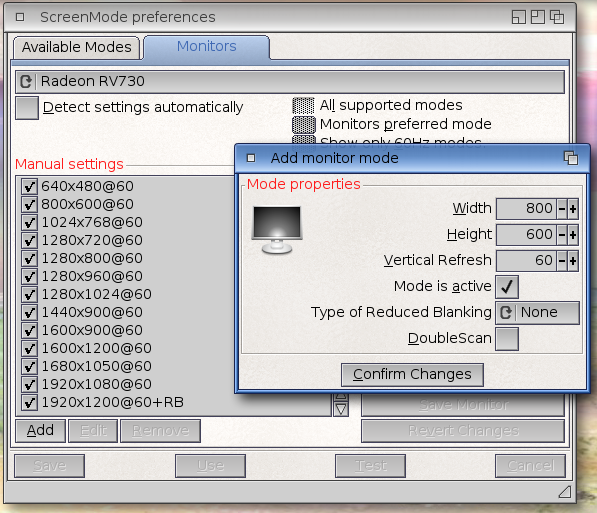

Is there a preferred way to add new monitor modes in OS4.1u6?
Yes, use SYS:Prefs/ScreenMode
Adding another mode line in the monitor tooltype
Did you add +RB?
MODE=1920x1200@60+RB

themamboman wrote: Is there a preferred way to add new monitor modes in OS4.1u6?
Like ZeroG said, use the ScreenMode preferences. On the Monitors tab, there is a button to add new screenmodes (see attached picture). You may need to change the type of reduced blanking to get some screenmodes to work. I had to add +RB to the 1920x1200 screenmode, but your monitor may need different settings.
