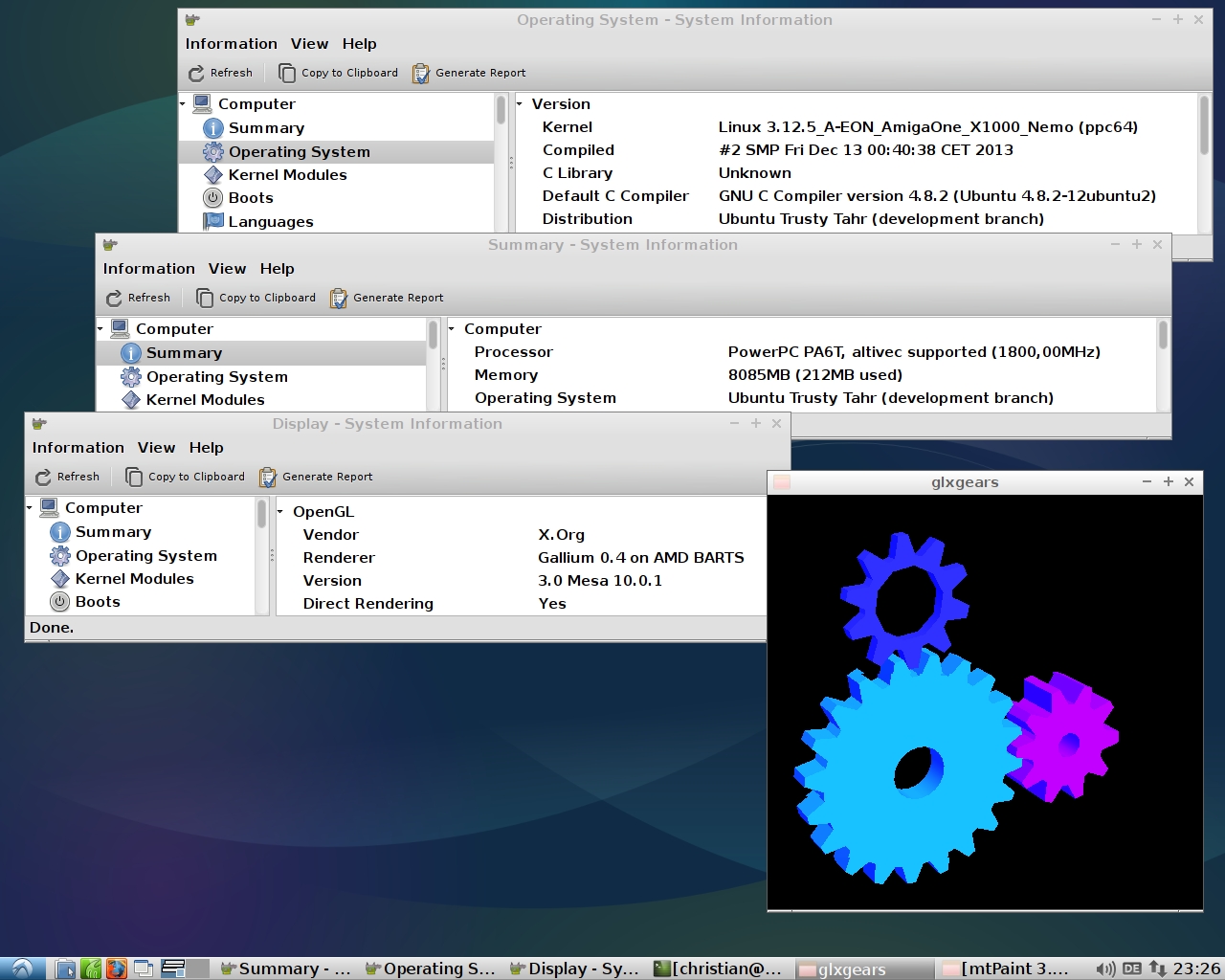

Hi,
I have installed the development branch of Lubuntu 14.04. It works but with wrong colors in games (see bug report: https://bugs.freedesktop.org/show_bug.cgi?id=72877).
(503.37 KiB) Downloaded 474 times

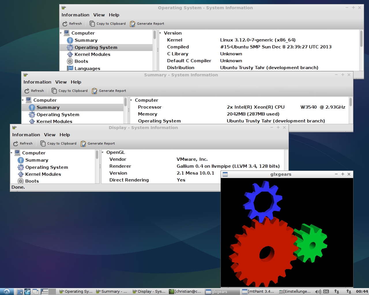

The PC version hasn't the problem with the wrong colors.

There are two main issues. Mesa issued false colors in games. They appear to be ABGR instead of RGBA, thus green becomes purple, red becomes light blue etc. I figured out what the problem is and I fixed the problem in the MesaLib source code. I released some unofficial Mesa packages. Downloads: supertuxkart-amiga.de.
