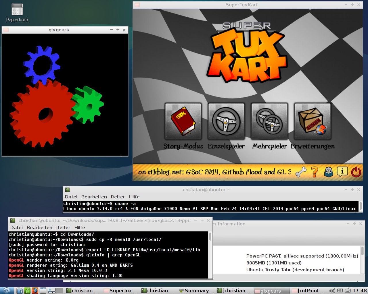

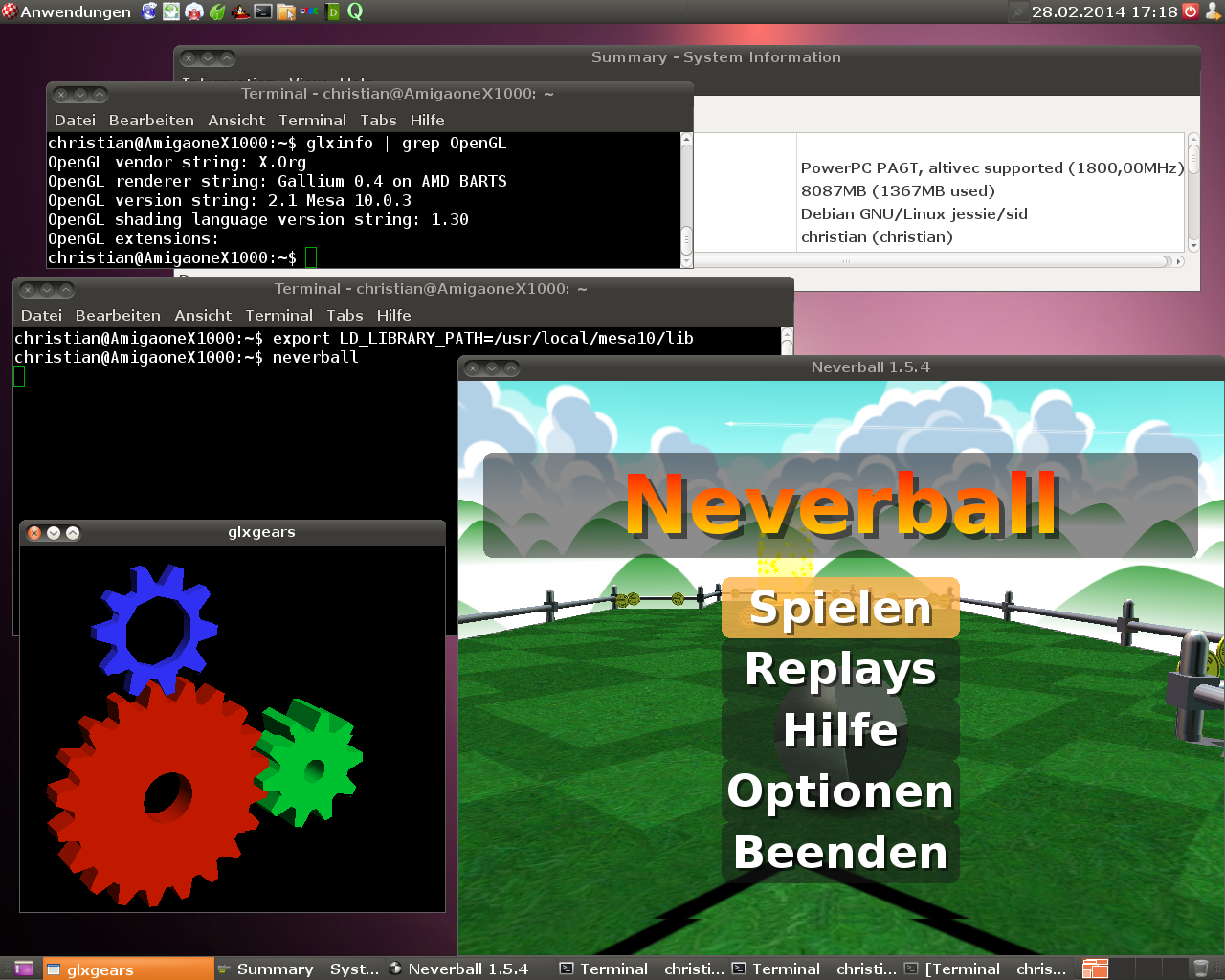

Posts: 11519
Re: Mesa 9.2.2-1 and 10.0.0-1
Mesa 10.0.3 successfully hacked :-D
I've figured out that the following line in "src/gallium/drivers/r600/evergreen_state.c" the problem is. :-)
case V_028C70_COLOR_8_8_8_8:
When I comment out this case then the colors are to 99% right.
But if I comment out the following lines then all colors are correct.
/* 32-bit buffers. */
        //case PIPE_FORMAT_A8B8G8R8_SRGB:
        //case PIPE_FORMAT_A8B8G8R8_UNORM:
        case PIPE_FORMAT_A8R8G8B8_UNORM:
        //case PIPE_FORMAT_B8G8R8A8_SRGB:
        //case PIPE_FORMAT_B8G8R8A8_UNORM:
        //case PIPE_FORMAT_B8G8R8X8_UNORM:
        //case PIPE_FORMAT_R8G8B8A8_SNORM:
        //case PIPE_FORMAT_R8G8B8A8_UNORM:
        //case PIPE_FORMAT_R8G8B8X8_UNORM:
        //case PIPE_FORMAT_R8G8B8X8_SNORM:
        //case PIPE_FORMAT_R8G8B8X8_SRGB:
        //case PIPE_FORMAT_R8G8B8X8_UINT:
        //case PIPE_FORMAT_R8G8B8X8_SINT:
        //case PIPE_FORMAT_R8SG8SB8UX8U_NORM:
        //case PIPE_FORMAT_X8B8G8R8_UNORM:
        //case PIPE_FORMAT_X8R8G8B8_UNORM:
        //case PIPE_FORMAT_R8G8B8_UNORM:
        //case PIPE_FORMAT_R8G8B8A8_SINT:
        //case PIPE_FORMAT_R8G8B8A8_UINT:
                return V_028C70_COLOR_8_8_8_8;
Neverball, Glxgears, and SuperTuxKart works fine with the right colors.
(673.26 KiB) Downloaded 462 times
Posts: 11519
The unofficial Mesa 10.0.3 works well on Debian Sid and on Lubuntu 14.04. I've uploaded it.
Download: MesaLib-10.0.3-powerpc-unofficial.tar.bz2
Note: If you use (L)Ubuntu 12.04.4 or Debian 7 with Mesa 8.X or 9.1.X, you don't need the new Mesa. Mesa 10.0.3 is not faster than Mesa 8.X or 9.1.X. ;-) It's only for new distributions like Debian Sid and Lubuntu 14.04.
Install instructions:
  1. Unpack the archive MesaLib-10.0.3-powerpc-unofficial.tar.bz2
  2. Copy it as root to the directory /usr/local/
    sudo cp -R mesa10 /usr/local/
  3. Set up the new library path
    export LD_LIBRARY_PATH=/usr/local/mesa10/lib
  4. Test it with glxgears. When you see the correct colors then you use the new version of Mesa. After that you can start some games for example Neverball.
SuperTuxKart needs a special run_game.sh for the new Mesa:
LD_LIBRARY_PATH=./bin/:/usr/local/mesa10/lib bin/supertuxkart
Have a lot of fun with the new Mesa. :-)
