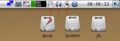

I vaguely recall a white dot for Application Dockies. However I haven't seen it for years, I think I must have either switched it off, or it only occurs under certain circumstances (maybe when there's no title?). I can't reproduce it anyway, even iconifying an MUI app to the dock.kas1e wrote:1. Add ability to disable identification of running apps by a white dot (pretty visibly when you for example set in mui apps iconify to amidock)

Ah, found it. If you set "Icon Names" to "None" in the prefs for the dock, all the titles disappear and the application dockies get a dot added. Any of the other options, and no dot is present (the application dockies are identified by their title being underlined).chris wrote:I don't, so there *must* be a setting somewhere already (probably in AmiDock's settings).Raziel wrote:I have the white dot (never knew what it's for, though) under the dockies of Wet, AmiSystemRestore and YAM, not under AmiUpdate.

@chris and all
About white dot, that how it looks like if i design dock to be at top of wb (looks pretty strange as for me, so to have option to remove that identification by white dot will be at least give one more way to do better design by users):
