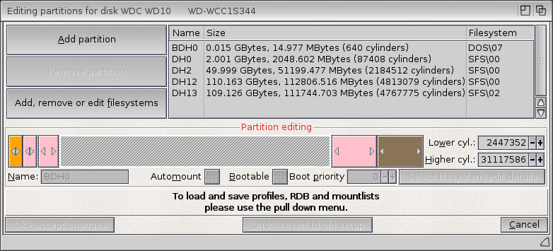

Hi, I have found a bug in MediaToolbox 52.12 (15.02.2009).
In the "editing partitions for disk -something-" window it is not possible to add a new partition into the free space between two other partitions.
It's only possible to add a new partition to the end of the disk.
Bug in MediaToolbox 52.12

Thanks.
I tried again and it seems that is possible to add a new partition between dh0: and dh2: but not between dh2: and dh12:.
Thanks.

I have created mountlists for all partitions, a text version of the RDB and some new screenshots.

You are correct. It seems I can't create a new partition between two other partitions if there is an unpartitioned area on the far left of the disk. I'll file a bug report about this if someone else hasn't done so already.ZeroG wrote:@MichaelMerkel

EDIT: I managed to find a solution...I have also run into this problem.
Now that I know about it I can make a workaround
When Media Toolbox refuses... select the left most area of the disk and create a partition there...
After that (no initial free space) It *will* let you make a new partition elsewhere (you can delete the temporary partition afterwords or leave it as non-automounting)
I however had other problems turn up which has seen me shift to a new HDD anyway.

This bug should be fixed in the latest SP_Engine which I've just uploaded for beta testing.
